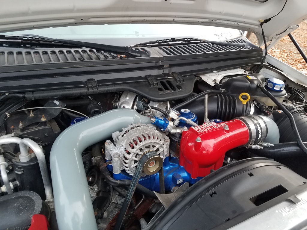

I had to take a break from it, everything works perfectly not a code on the scans so this can wait. For now gotta get a few things done with my truck before it gets cold, since it's too big for the garage. This thing always shocks me when I jump on working on it after months of E90, it feels like working on a Terex Titan or something. After a while it feels normal, then when I go back to the E90 it feels like working on a toy.
