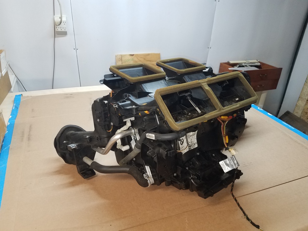

Mike K686.50

Cal122618.00
      10-18-2024, 10:18 PM   #2

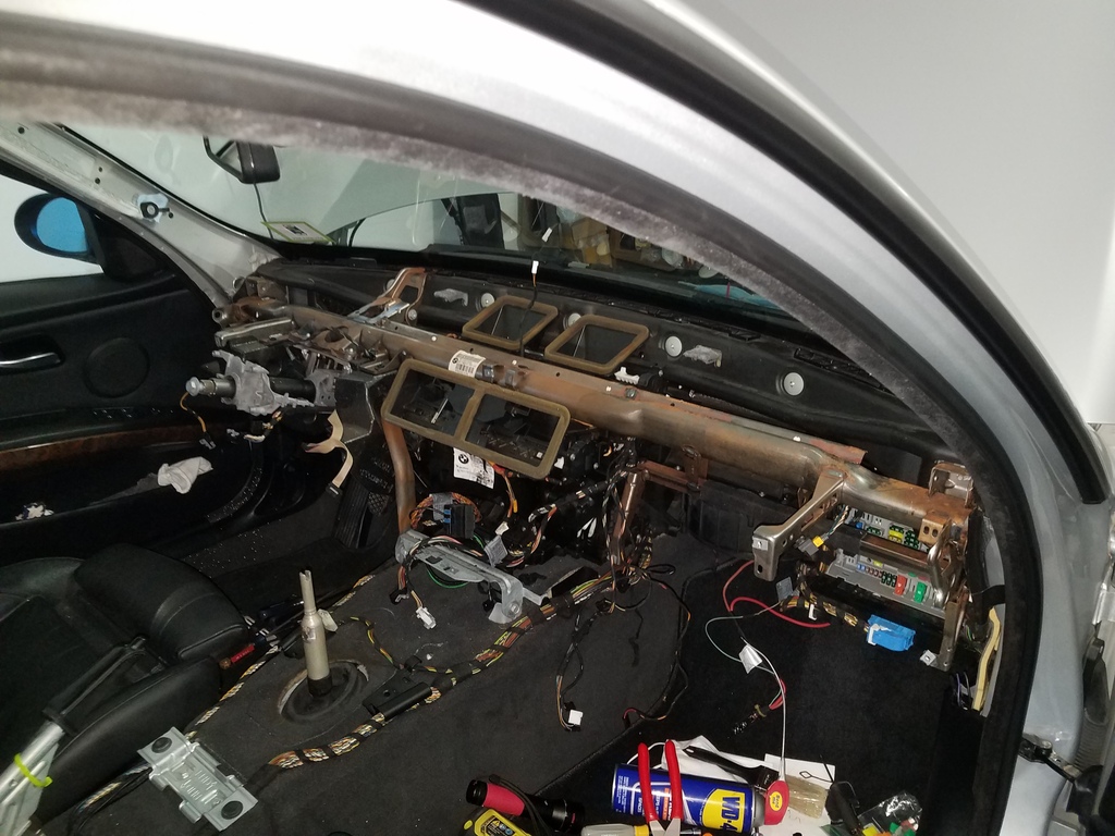

Well always wondered what it looked like on the firewall with everything removed, but not enough to take it apart. Now I know, got the HVAC box out today and new one should be here this week sometime. I need to take all the motors and wiring and other assorted parts off it to swap over, hopefully it will be simple but yeah lol to that. Now I know why lotta shops don't do HVAC and the ones that do make you bend over and spread em for it.
I hate how much those bars rust. Such an eye sore anytime you take something apart on the dash. I know it's hidden but my OCD knows its there. LOL
I bet Jake paints his to make it nice and purdy!
yeah, oh my god, the evaporator is sandwiched in there real good, I guess a bad evap/AC leak will total an E90! LOL
Oh my! I'm afraid I would give up after removing the steering wheel. Your mechanical skills are ridiculous!
lol If it wasn't still attached by a wiring harness on the drivers side I'd prolly do that, as it is I'm just gonna wipe it down with some anti-corrosion spray and pretend I never saw no rust.
Seriously, if this was any kind of "just transportation" car I'd either junk it or live with wherever the heat wanted to come out, only for my bimmer babies would I do this job from hell.

It's always nice to have brand new stuff, be glad when it's there lol. Here's pics, on the left is evaporator, right is heater core. The cabinet and these cores are Denso, the cars also shipped with Valeo units which are slightly different.
