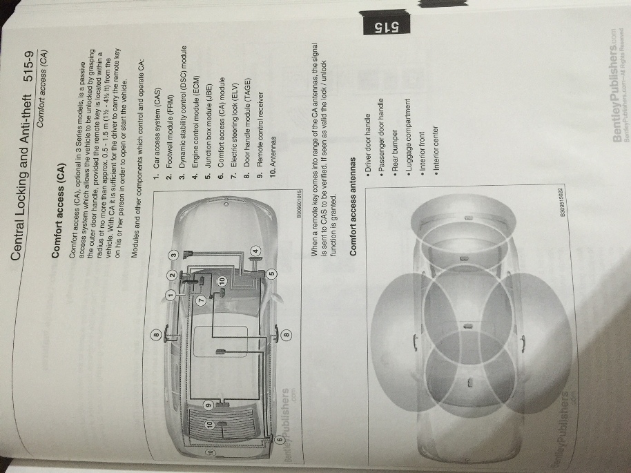

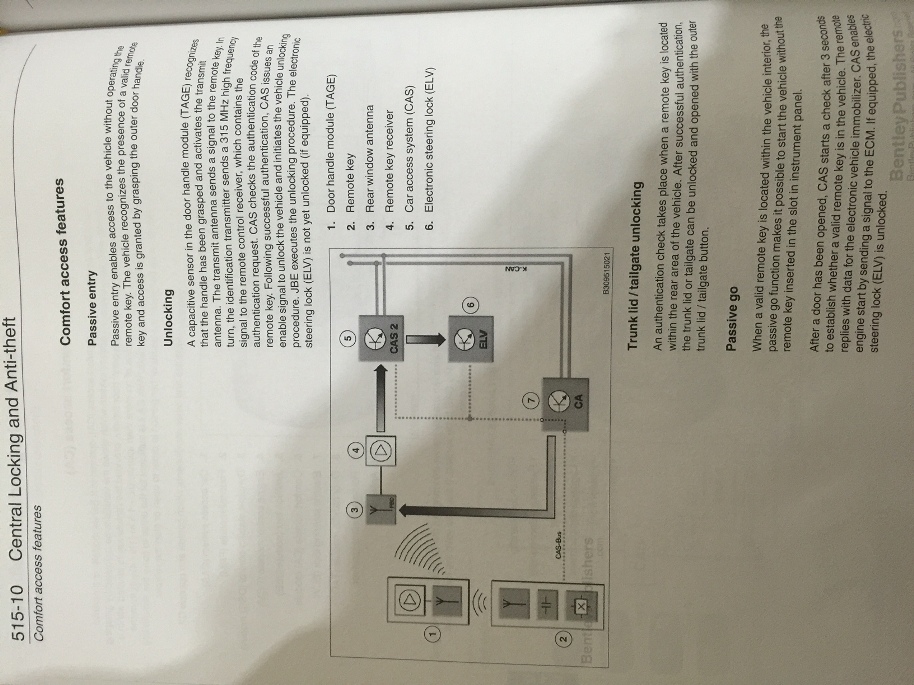

I took photos of these, in case they help!

Thanks FHE92, so it seems that the Comfort access wiring harness consist of wires to the 4 antennas, the CAS, the door handles and the Passive Module. I need to find out now what terminals, plugs I need to buy and also what wire gauge and I will try to build it.
I am having no luck in finding a CA wiring harness for sale.
On another note, I found some who will be able to get me the Key from BMW Germany. Its all down now to the CA wiring harness
