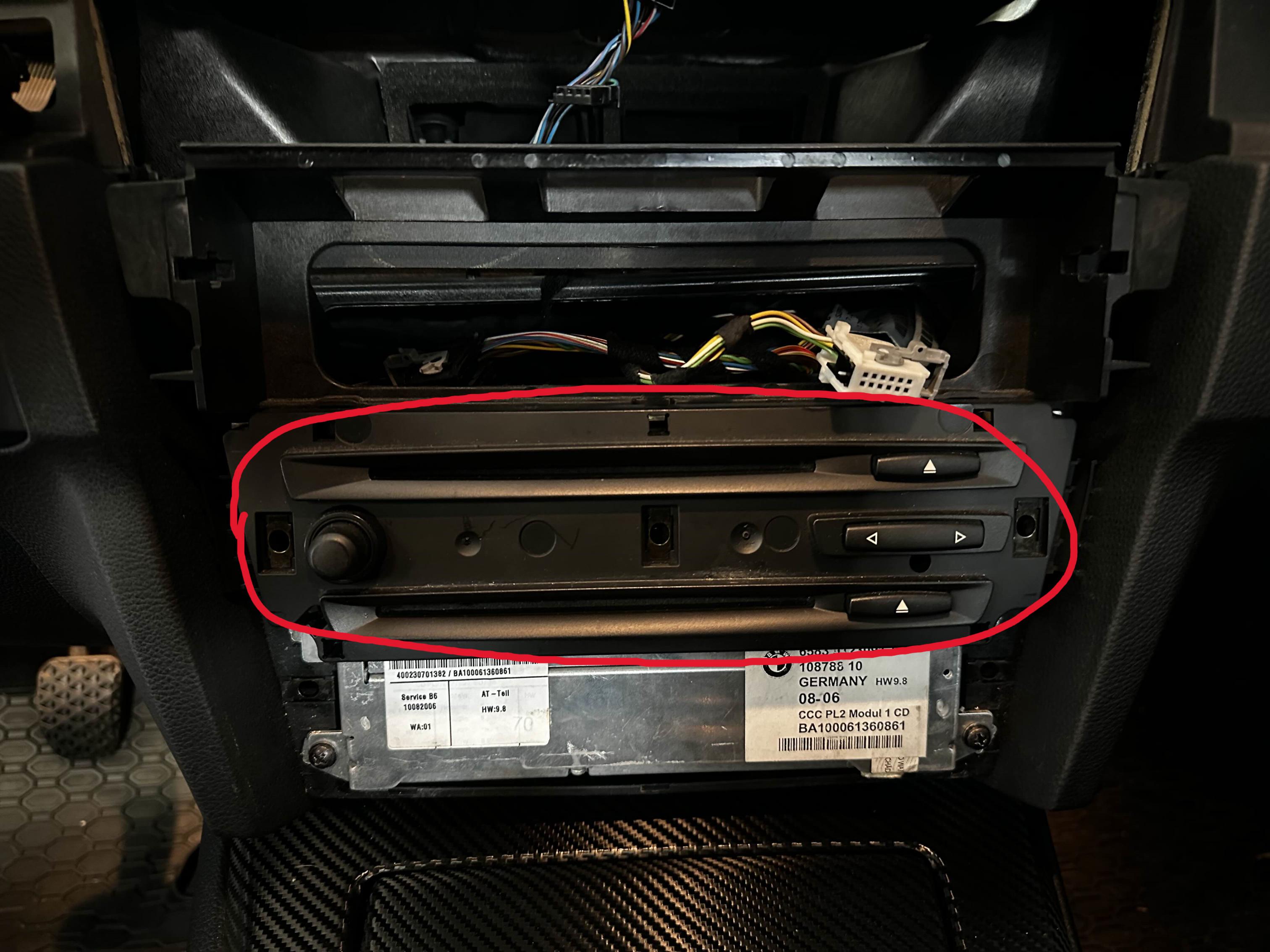

That makes 2 of us, I scare myself on the regular. Today I'm stuck once again, I thought swapping the actuators would be a simple task, but the motors are in such a position that it's impossible to get them over the star shaft of the flaps unless the flaps travel past the stops, which obvs the can't do without breaking off. I think I'm gonna have to slap it all together enough to turn the car on so I can ISTA the flap motors into a more agreeable position... hopefully. Today is 80 degrees here in south jersey so I'm taking the pupper and Mrs. 3P to dog beach, I'll think on this problem on the ride. Thankfully the 330i is running perfectly
Originally Posted by Efthreeoh View Post
Back in the day I was installing a new radio in my wife's Z3. An aftermarket Alpine. New speakers, and added speakers to the bridge behind the seats. A complete rewire job. I had the entire interior out and the center of the dash out. Ms. Efthreeoh came over to the shop during the surgery and freaked out seeing her car gutted to stuch a state.
I avoided this kind of scenario by letting Mrs. 3P buy herself a new car, she picked a Hyundai Santa Fe which I have zero interest in working on so no freakouts lol.

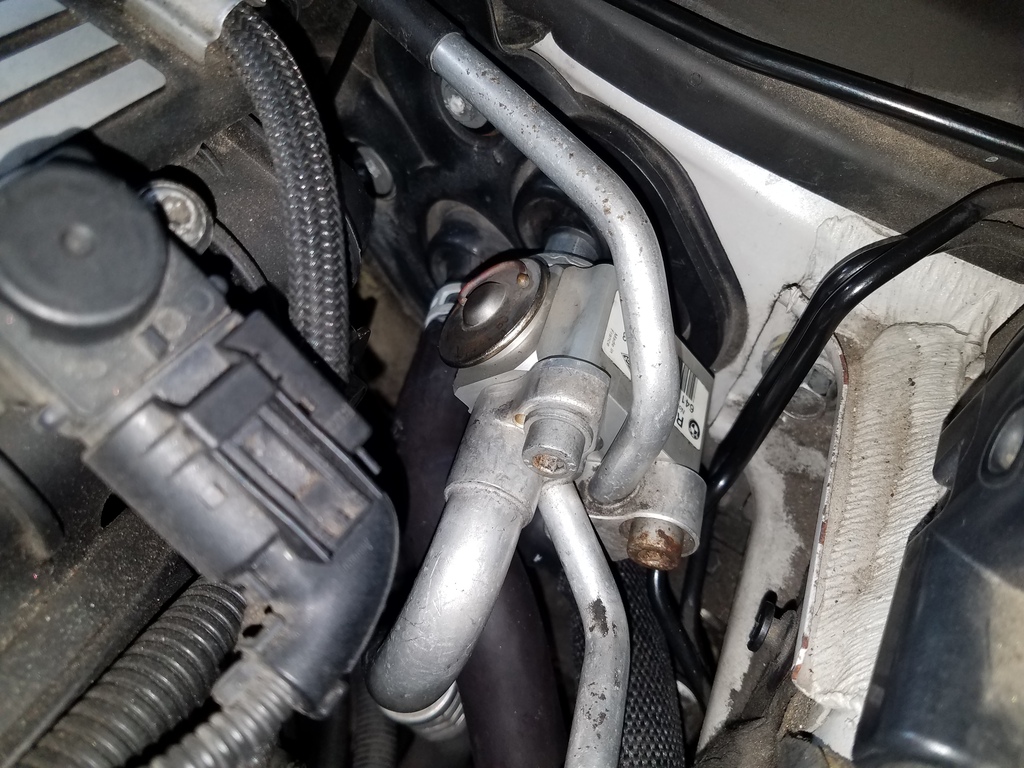

Tip of the day for those unfortunate enough to find themselves in the middle of this task. When you go to reinstall the HVAC cabinet, the main mounting "nut"/"ferrule" has plastic prongs before the threads start, you have to push the bolt in HARD to get it past these prongs. Don't lean in there to one of the most inaccessible spots on the car, the firewall directly behind the CCV hose, desperately spinning the bolt with your fingertips for an hour trying to get the threads to start like I did. I finally had a peek at the old box and figured it out, after that it went in fine.
Got cabinet, the cage and the new heater hoses and AC o-rings installed in the engine compartment and got that buttoned up. I found a cabin filter housing with the wire loom clips not broken off cheap on ebay so got that in place too.
Have to stop here because waiting on new foam gaskets for the vents where they meet the dash, should be at the local stealer tomorrow.

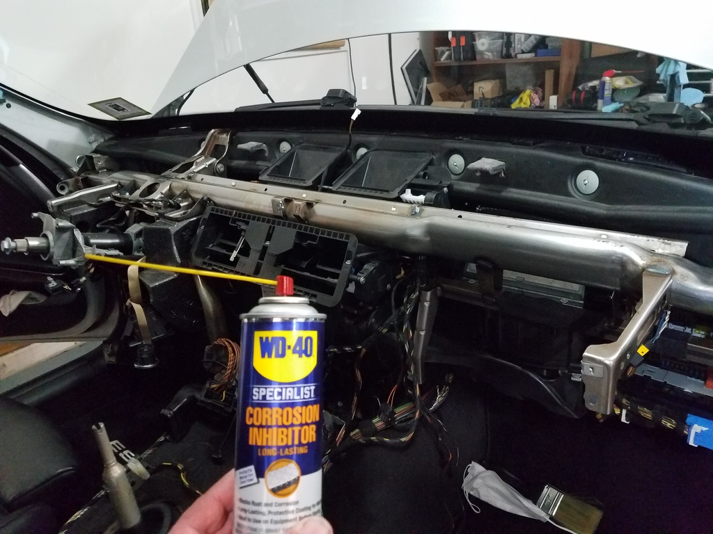

I've found WD-40 specialty products to be pretty good stuff BTW.
Their namesake product is fine for what it was intended to do as well.

Found the problem
In my case IT WAS THE CCC HEADUNIT more precisely it was this plastic trim on the CCC head unit when I put pressure on it the creaking disappeared instantly when I stopped holding it the creaking reappeared.
SS
