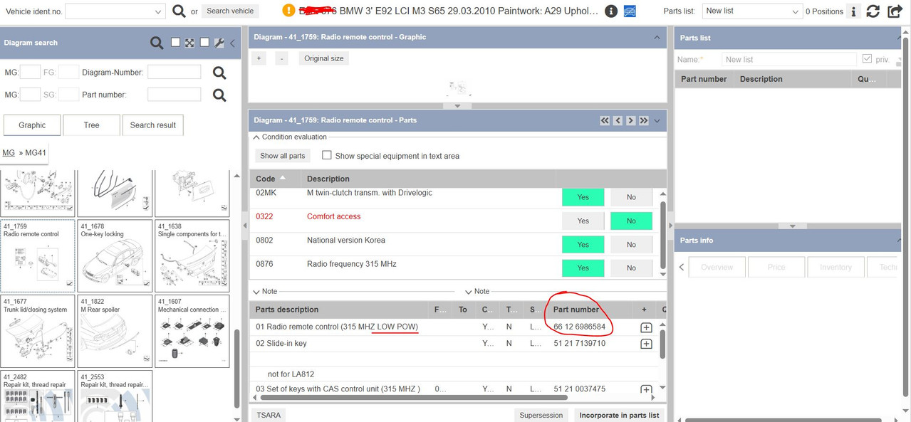

as discussed over the email, my advice is not to change anything and just get you original CA Key.
don t know what Low Power means in terms of usage, it might be that range will be limited but maybe people who are using LP CA keys can share more info
i send you email with print screen from ETK
CA KEY part# 66 12 9268486
it doesn t seem to be LP (Low Power)
only for the non CA key it s mentioned the LP (Low Power) note

Thanks for the update, dumitru.
Low Power means literally it has low power radio compare to normal 315mhz as certain Asian countries like South Korea and Japan has slight different radio regulation so the BMW made it for specific market for Korea and Japan. I was told by TOYNAM who did this retrofit, he ended up installed an aftermarket comfort access kit because of the frequency issue. I just wanted to make sure this CA key as specified from ETK would work perfectly work with the car being use 315lp mhz frequency.
Any comments from Korean or Japanese users are welcome!

i don t understand what freq issue he had. both keys work on the same freq, that is 315Mhz
I was told that they are not compatible.
below is what I found from Gemini. Please correct me if I am wrong.
1. Definition of 315LP (Low Power)
315LP stands for "315MHz Low Power." It is a specific RF (Radio Frequency) variant used by BMW for remote keyless entry and Comfort Access systems in regions with strict radio frequency regulations, such as South Korea and Japan.
- Power Output: As the name suggests, the signal strength is lower than the North American standard to comply with local laws (e.g., South Korea's Radio Waves Act).
- Modulation/Bandwidth: While the center frequency is 315MHz, the signal modulation and bandwidth are narrower compared to the standard version to prevent interference and meet "Low Power" device criteria.
2. Compatibility: 315LP vs. 315MHz
Technically, they are not compatible. You cannot pair a standard 315MHz key with a 315LP system (and vice versa) for the following reasons:
- Receiver Tuning: The Diversity Antenna and the CAS (Car Access System) module are hardware-tuned to specific signal profiles. A 315LP receiver is designed to filter for low-power, narrow-band signals and will likely reject or fail to "hear" a standard 315MHz signal correctly.
- Protocol Mismatch: Even if the frequency is identical, the data packets sent by a 315MHz key are often modulated differently than those sent by a 315LP key, causing the CAS module to ignore the command.

Hello,
I replied to your private message. sorry for the late reply.
315MHz LP has the different radio modulation method (called ASK instead of normal one called FSK according to my research) but as I mentioned in the message you do not need to care as long as you order the key through the official channel. The radio modulation type should match between the key and the diversity antenna.

from what i know, the diversity is not different, the only thing is to have it on the proper freq (like not installing an european one in a japanese car)
for sure the CAS with PGS and diversity can work with both keys (LP and normal) as long as the freq is the correct one
Note: of course talking about original CA keys released by BMW on your VIN
