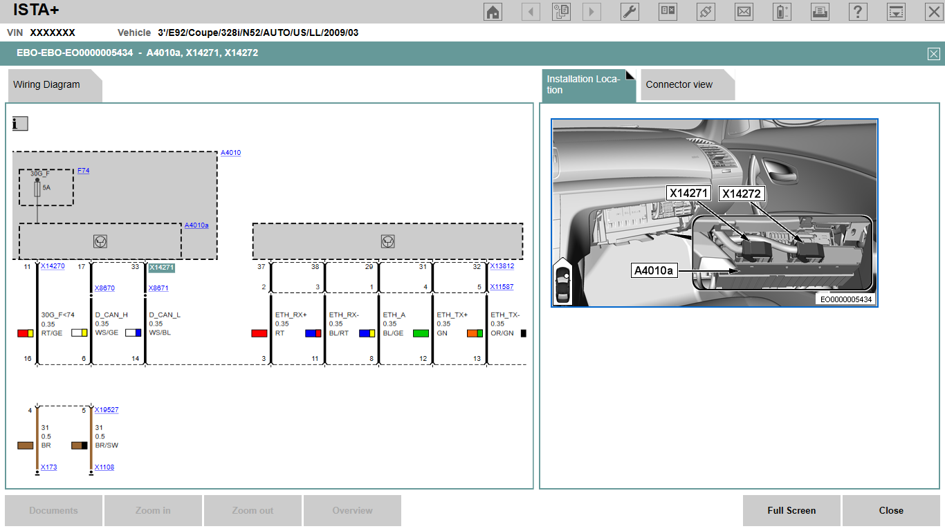

Attached to NEXT Post, so as not to ruin margins here, are ISTA ScreenPrints showing your OBD II wiring & the Blue X14271 Connector at the JBE where the D-CAN bus wires from X19527 OBD II connector attach. There are TINY numbers on both the OBD X19527 connector, & the Blue X14271 Connector, which identify Socket Numbers. The White/Yellow wire from Socket #6 of X19527 (X19527/6) goes to X14271/17 (Socket #17 of X14271). Likewise, the White/Blue wire from X19527/14 goes to X14271/33.
The Blue X14271 connector at the JBE (Junction Box Electronics) module is next to the Black X14272 connector. It can be accessed by removing the two T-20 Torx-head screws, on either side of the trim panel beneath the Glovebox. After removing those two screws, unhook the plastic catch on inboard side of panel, drop down, & remove the footwell light connector by "jiggling" & gently pulling away from light bulb. Lift/pry the latch of X14271 over the catch, & pull connector toward you.
Inspect the Sockets of X14271 for any moisture or corrosion, particularly at Sockets #17 & #33, White/Yellow & White/Blue wires. Also inspect the pins of the JBE, particularly those which connect to X14271 sockets #17 & #33. Use Electronic Contact Cleaner (CRC brand/Walmart) to clean pins/sockets & reassemble. Check OBD function & report your findings. We can suggest NEXT Steps. If still need help, please provide info described above.

Attached are ISTA ScreenPrints for 2009 328i OBD II to JBE wiring, per prior post.
George
