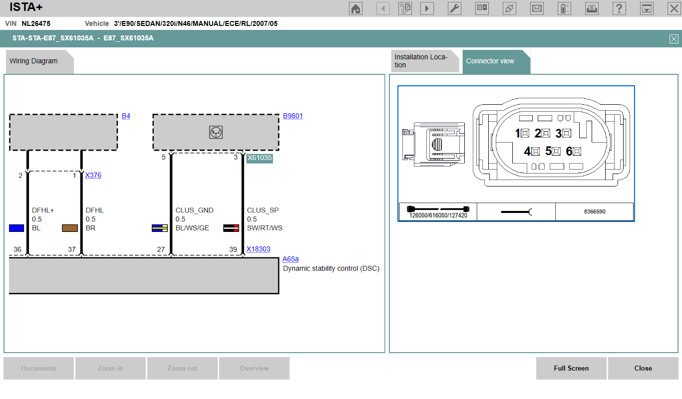

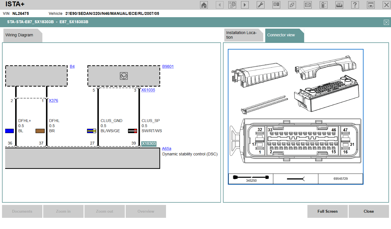

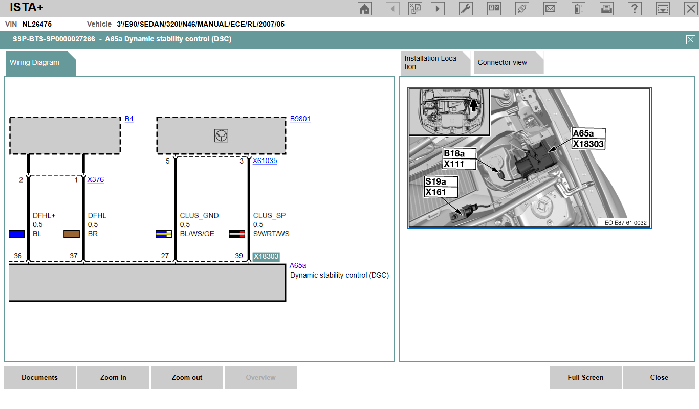

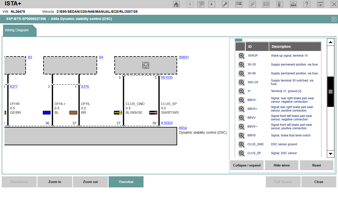

Originally Posted by wdwyerr516 View Post
... code 5E30 on ISTA...
Attached are ISTA ScreenPrints showing wiring diagram (SSP), Location, & Connector View of B9801 DSC Sensor.
Also attached are ISTA Diagnosis Scan ScreenPrints from my 3/2007 328xi showing Values at Rest, for DSC Sensor.
Some diagrams appear to show LL instead of RL (RHD) configuration.
Also, pdf: Fault Memory & Test Plan, explaining HOW to view various ISTA Screens, with ScreenPrint Examples.
George
