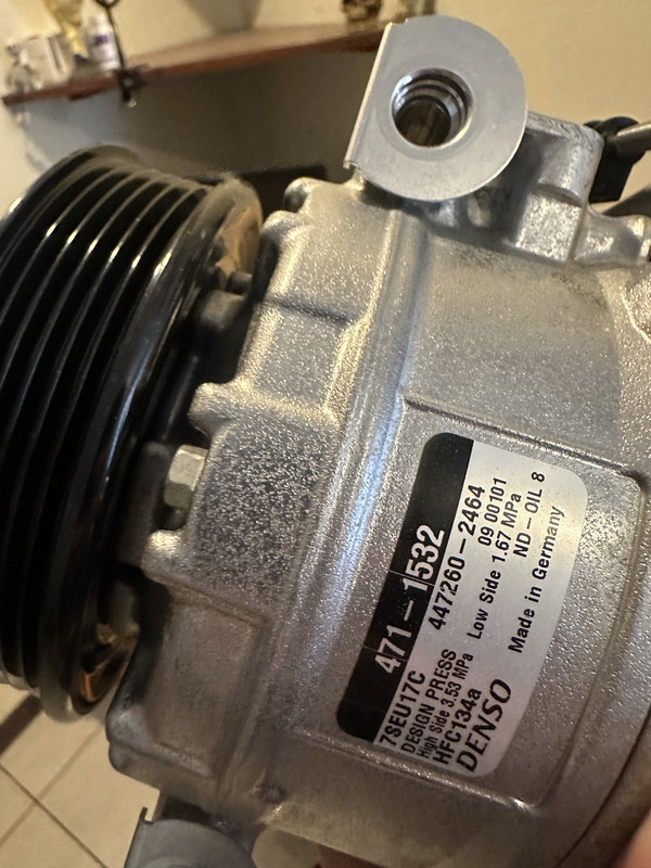

Walmart will source from other suppliers, got an Advance Auto box one time. Amazon does the same thing. But these should all be better than third party selling on either platform.
That Denso compressor is made in Germany. Nice!

Genuine used compressor from eBay:
Denso, with BMW part #, looks good but we shall see after installation. Different than the photos of what you guys posted because N54 & N55 E9x uses a different compressor than the N52. So far my 330i AC compressor is a workhorse, blasting ICE COLD air from the vents!
