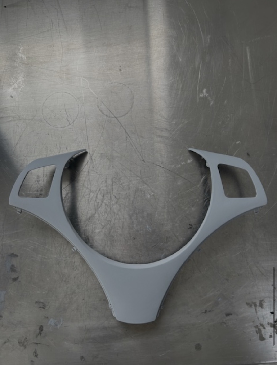

Removed the steering wheel interior trim and refinished that

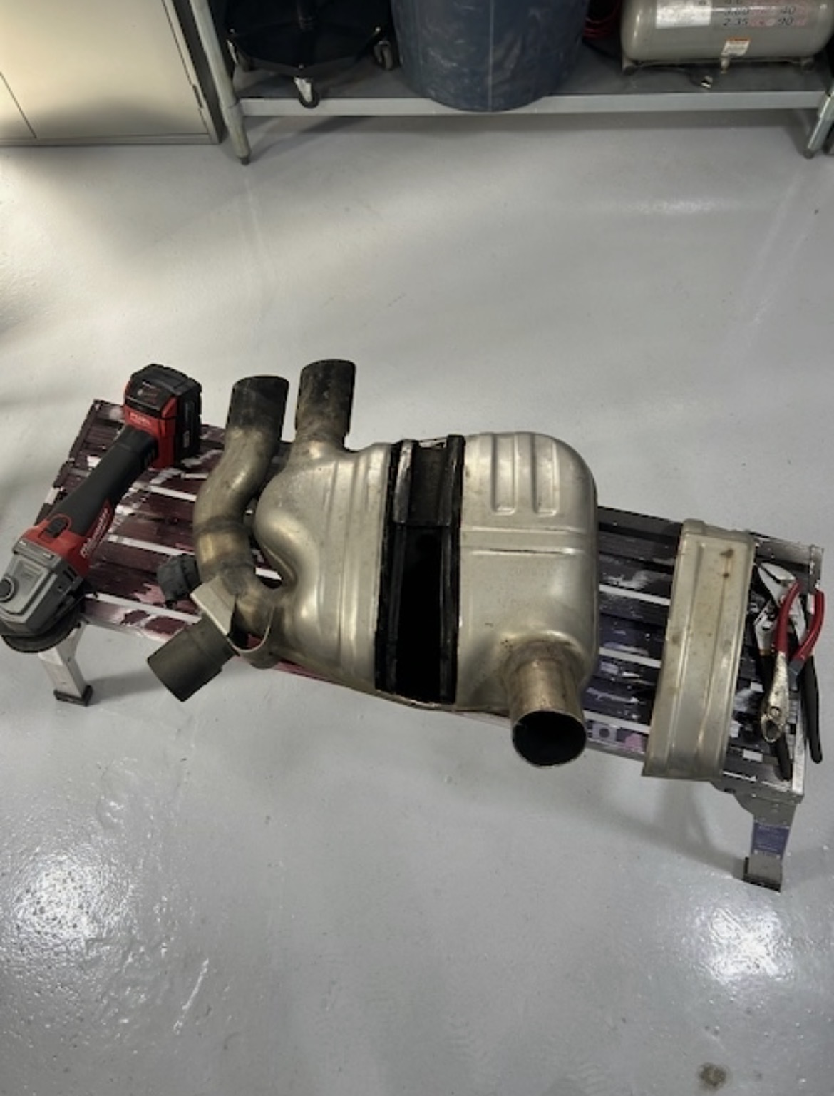

I purchased a e82 135i stock rear muffler section. I had stumbled upon thread on here with a modified stock 135i rear muffler section that sounded great on a e90 n51/n52. It shaved some weight from the factory stock rear muffler and seemed to be easy to retrofit. So I decided to do that.
I cut open the muffler and modified how it was described on the other thread.
The center section of the muffler I cut open. Inside that section is two pipes. I welded up the three large round holes on the one pipe and half of the smaller perforated holes on the other pipe. Then welded it back up.

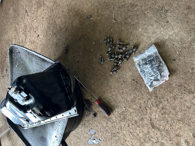

I had booked the car in for replacing the Oil pan gasket. It was leaking pretty bad when I had the car PPI’d in Vancouver. Common issue and what bmw doesn’t have an oil leak right?

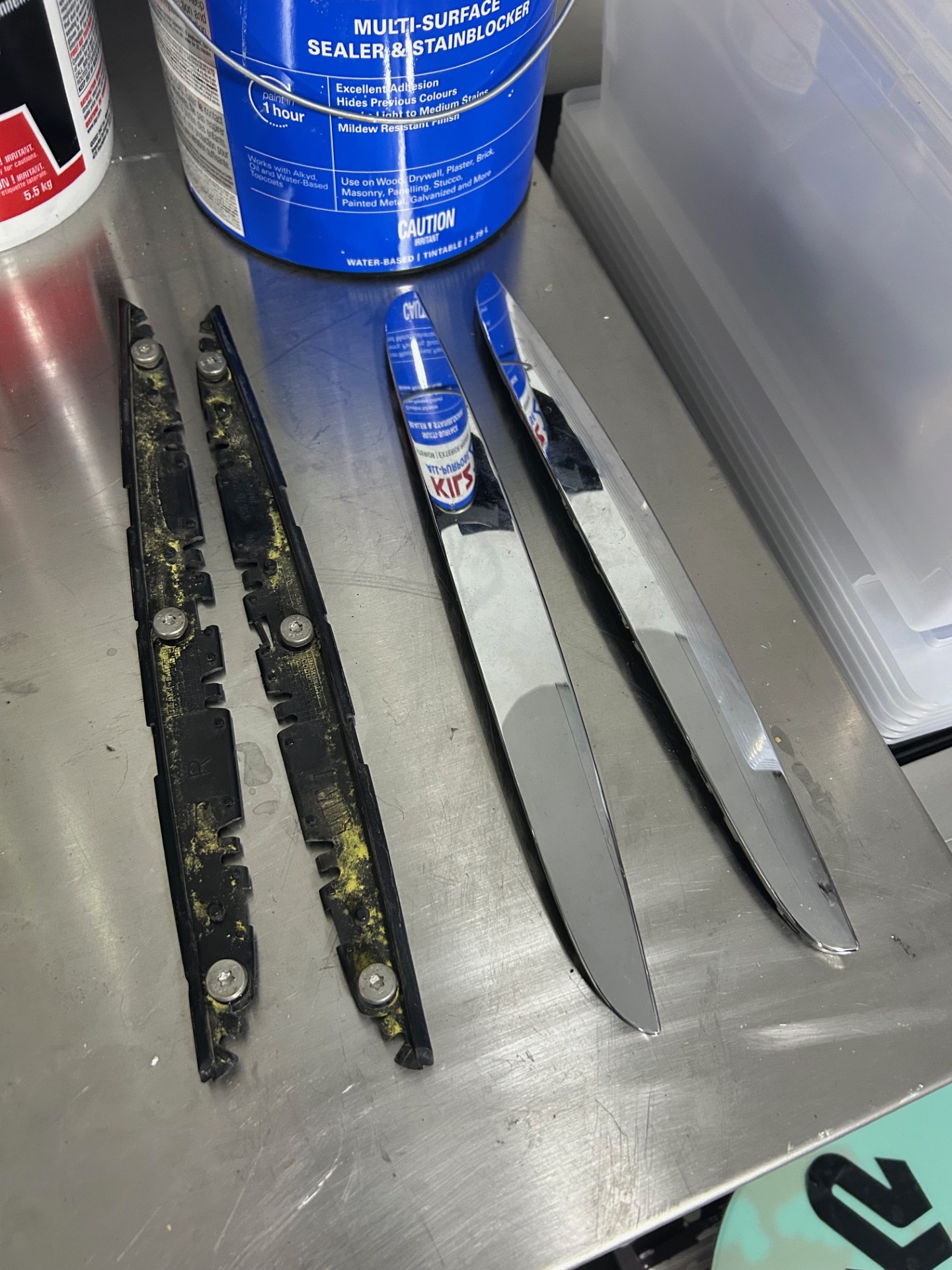

While I was at it I smoothed, primed and painted the front license plate bracket bodycolor as well.... Incase I ever need it (Ontario front plate laws). I always liked how the E9x M3's had body colored plate brackets from factory.
I removed the front hood moldings, took them apart, Sanded them, primed them and refinished those bodycolor.
