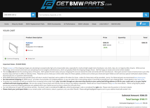

Tischer BMW has it. Both kinds (for either ULEV or SULEV) are $366.55.
IMO, Tischer FTW. Although you get lifetime replacement for about $465 from FCP.
https://www.getbmwparts.com/v-2006-b...and-components
I almost just bought a spare when I saw that!
I think that's a mistake on their listing. Those part numbers correspond to manual and automatic versions of the ULEV radiator, afaict. 17117537292 is the actual number for the SULEV (N51) verison.

Yeah, best to let Tischer use the VIN number to look up just in case.
The 17117537292 for N51 is $768.67, but that includes the special sensor (which I think is just a plain pressure transducer because of the 3 pins).
For N51 I think the plastic tank CSF is the only aftermarket option because of the sensor port. But for the creative, one might be able to convert the all-aluminum N52 CSF radiator to N51 use.

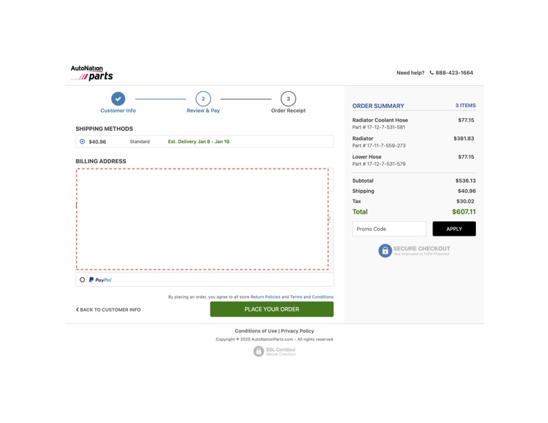

Thanks. Interestingly, the Tischer/GetBMWParts appears to be the same interface/web presentation as the AutoNation BMW parts portal for the Tucson BMW online. https://www.autonationparts.com/v-20...and-components
The payment, VIN verification, etc. is identical. I don't know if that means same underlying company or two companies using the same web interface.
The GetBMW parts however has a $267 shipping charge vs a $40 for the AutoNation page. Delivery is ~Jan 10 however.
Dealer is $150 more for same after online shipping costs. The dealer is supposedly 1-2 days delivery to the dealer. So it comes down to how long I want to wait and how bad I want to see the actual parts I'm buying before I walk out. I would really like to be sure it's something made in Germany or Hungary, etc. vs China. I have bought rotors from the dealer once and found they were made in Mexico so can't be sure about country of origin anymore.

It does look like the same web interface. Yeah Tischer needs to look into their website. I saw that ridiculous (freight) shipping charge, with a note that more shipping options are available on checkout. That will drive potential customers away for sure.
Then I tried again, it is $50.36 from Maryland to Phoenix, AZ.
Well you will receive it sooner from AutoNation anyway as it is closer, likely from the same BMW distribution chain but different warehouses.

I just jumped online and saw the genuine is about $190 more than a Mahle.
I think I would do genuine. I just did a Lexus LS radiator myself, and I went with OE. The reason is I remember reading Denso for the vehicle is aftermarket. Lots on the forum went with Denso aftermarket "tow package" and it was stupid cheap like $90? 2 years later they leaked at the same place the original did. My car is 20 years old and it just leaked--I did not drive btw once I was aware.
Today it's $112 or $123. OE is $432 list and somehow I got it from a Scottsdale AZ dealer for 40% off, free shipping, and no tax? I was dumbfounded but I paid $260.
Again %-wise $190 is a lot more, but I'd pay it myself to know it's same as what came with the vehicle. Now if I weren't keeping the car then I would try to save... my .02
edit: The genuine OE Lexus part in 2025 was made in China, and the one that came out of the vehicle from 9/05 is Japan. I'm ok with it, prefer genuine for this type of part...

FWIW - I decided to buy BMW/genuine. Going to dealer was ~$130 more than thru Tischner/Autonation and ~$40 more than same on FCPEuro. I ended up going to local dealer as I've had problems with other online orders getting damaged via shipping and had some concerns on banging around the radiator. (Seems like UPS is hiring the equivalent of Uber drivers to drop stuff off in my area and they just drop and run)
I also wanted it quickly and wanted to see the thing before I bought it to make sure it wasn't made in China.
In any event, the BMW radiator was made in Germany. It wasn't packaged that great. Just some foam wrapped around the ends and put in a box. But the box hadn't been abused and radiator looked good.
I also epoxied the crack and it's lasted 3 weeks so far. But I'm not going to trust it in the summer here, driving to/from Phoenix, etc. so will replace when weather is nice.
