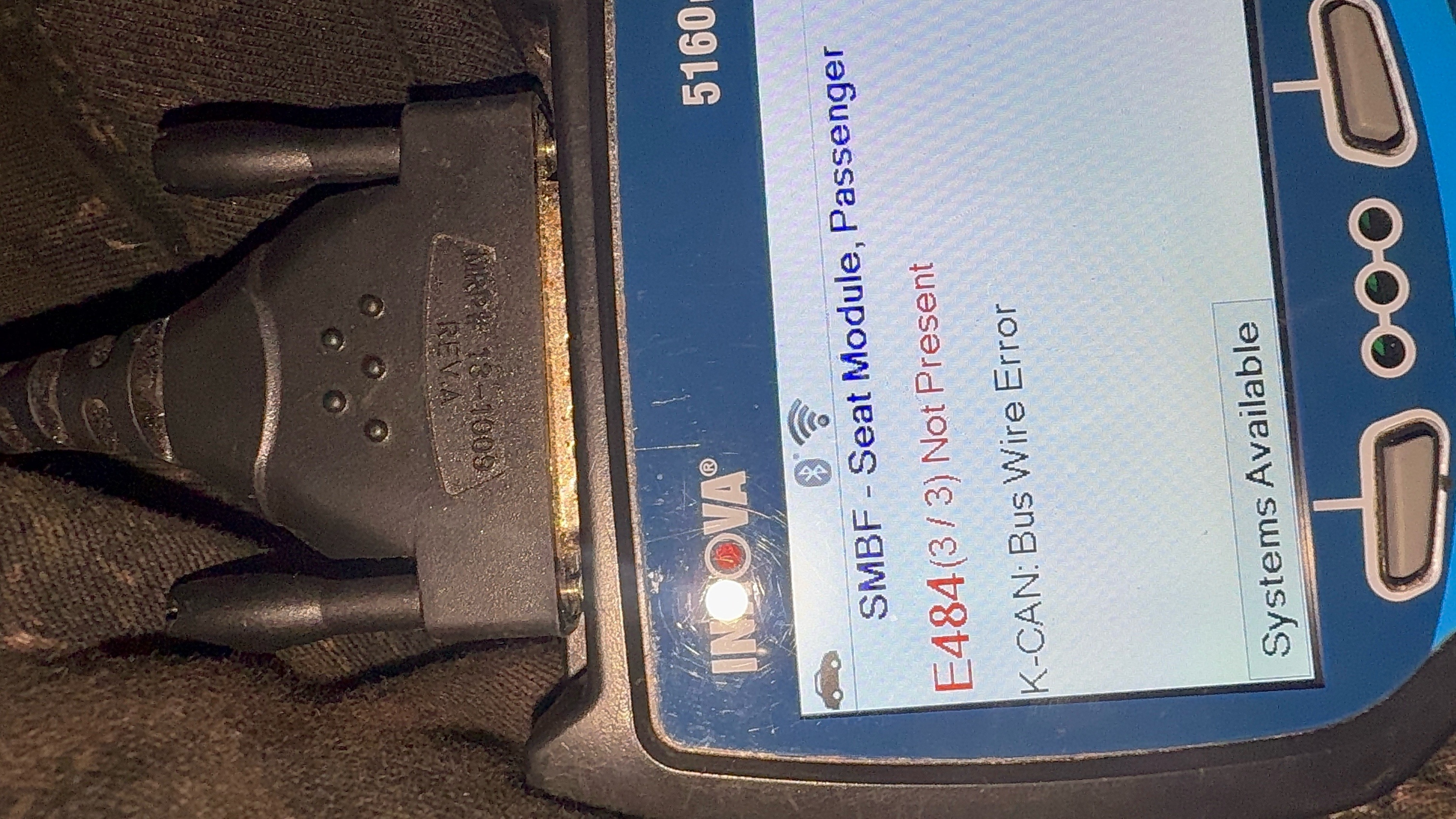

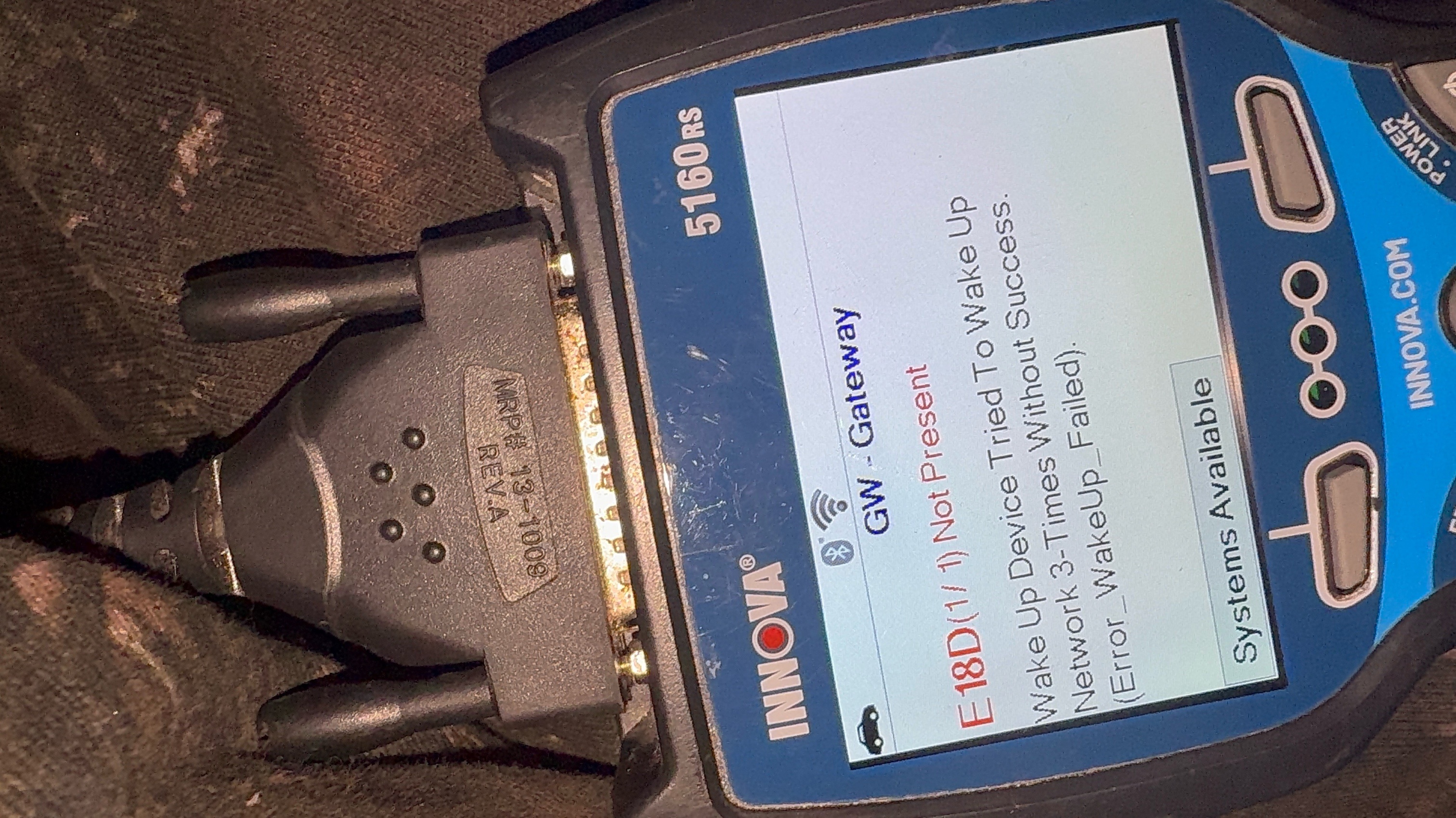

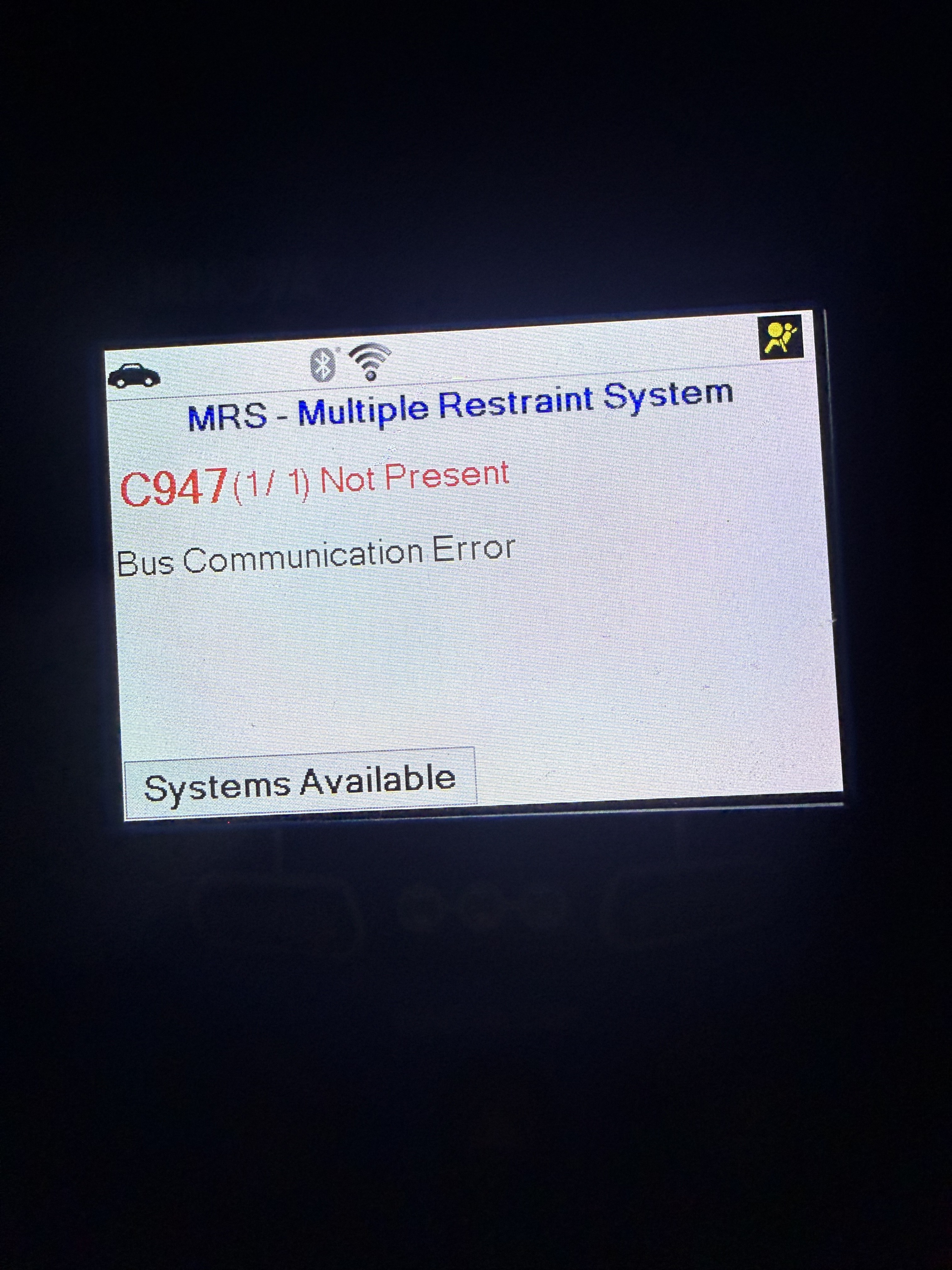

I got these 3 codes with an app but if you can point me to a good scanner id appreciate it!
