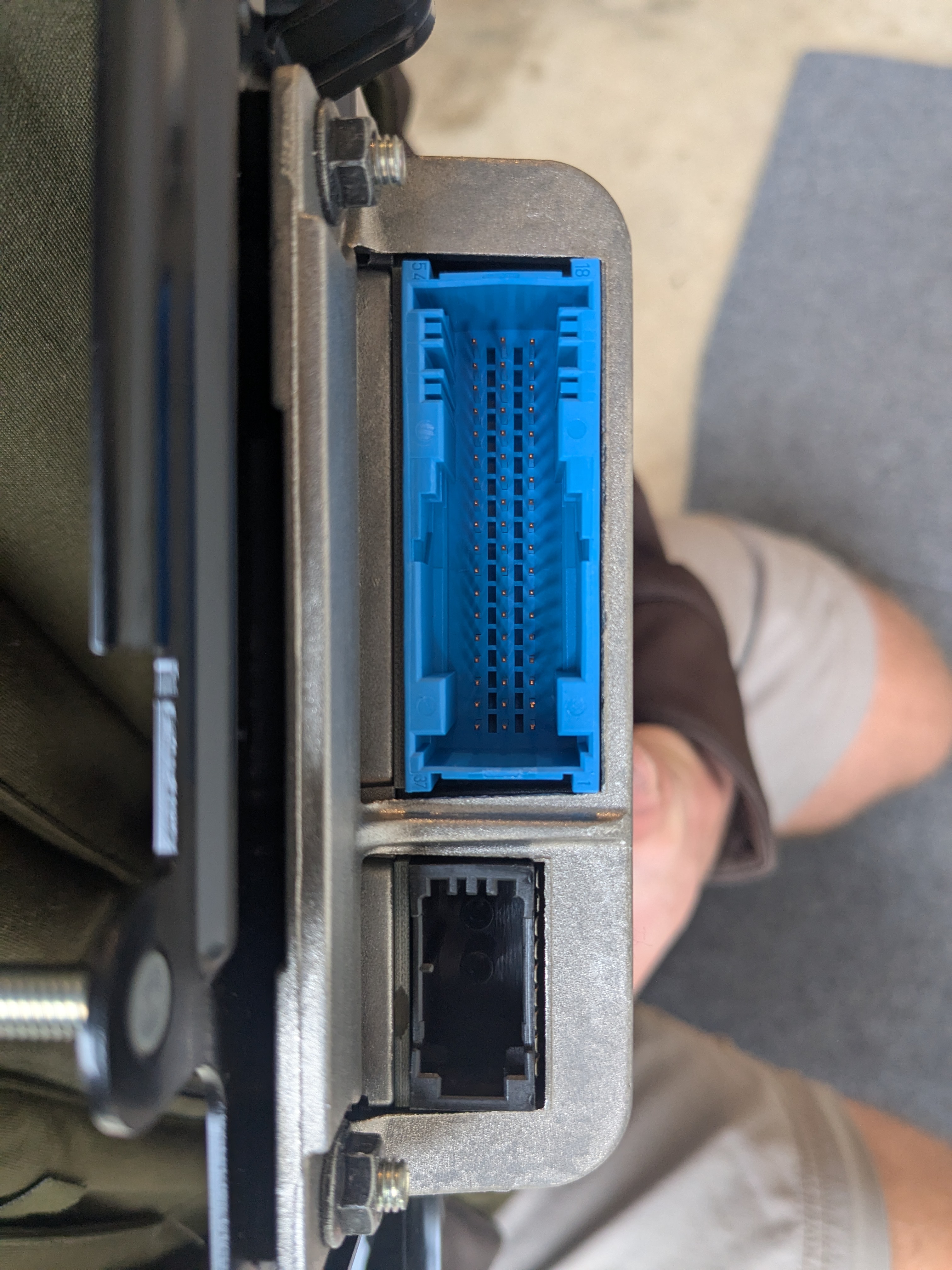

Hi there, I have a 2007 E90 323i. On my CCC head unit I have the option to select aux input for audio (it is not greyed out, it is bright white). My issue is when I select aux it shows the aux screen for a split second then returns it to the FM radio selection. Even if I select AM radio and then select AUX it randomly returns to FM radio. I have tried selecting AUX with my phone plugged into the AUX input jack with no difference. I have inspected my MULF unit also for any obvious damage with no luck. I have tried disconnecting/reconnecting the battery with no luck. I have checked that the AUX input jack is correctly plugged into its wires with no luck. Lastly, I have checked that the fibre optic cables between the MULF and the CCC head unit are both properly connected and both have red light emitting from ether end.

Hi there, its named a MULF 2 high SVS. I don't know what that means specifically, and I don't have a very good understanding of what exactly these modules do. See attached photos as well for exact details. Kind regards

Hi there, I have done the MOST bus test, I discovered that the MULF 2 HIGH module wasn't emitting any red light despite having red light being input into it. I did this by checking for red light downstream of the module at the diagnostic connector under the glove box.
Using a bypass connector I was able to complete the circuit of red light all around the MOST bus. However this did not fix my issue of being unable to connect to the aux input setting. The reason I tried this is because on my 2005 BMW E90 I can successfully select aux input when the MULF unit is disconnected (however there is the difference of the aux input not having the USB port next to it, whereas on this E90 there is a USB port next to my aux port).
So in conclusion, i believe that either my MULF 2 HIGH module or radio unit is faulty. Unsure of which one to replace first.

Hi there, sorry haven't had much time to work on the AUX issue but I value the help! I've used my multimeter to test for 12V on the blue connector that connects to the MULF module. Testing the red and brown wires I do not get 12V, it's showing basically nothing on about 0.1 volts. So I thought I'd have at all the fuses related to the radio and cd system as indicated by my fuse card, but couldn't find any faulty fuses. I checked the fuses for continuity with multimeter. Are there any other things to investigate that could cause no 12V power to be reaching my MULF? Kind regards!

Fuse and 12V supply has been fixed up now, thanks for you help! I'm still having no fibre optic (red light output) coming out of my MULF module, even though it is being powered up and I have confirmed there is no other break in the MOST loop by using a bypass connector to skip the MULF module. So in conclusion I'm fairly certain I have isolated the problem to the MULF module itself and I'm currently looking for a replacement. I'll make a post if replacing the MULF module fixes this fault for future reference if anyone else ever has the same issue. Thankyou ptpending

If you have the 6fl option = usb I believe the aux may come from the Mulf 2 hi .
so the module died and burnt the fuse
you can repair the module by yourself or by local repairer who can trace 12v supply circuit on MULF board,
i had such a case 14 years ago with my first MULF2HIGH
