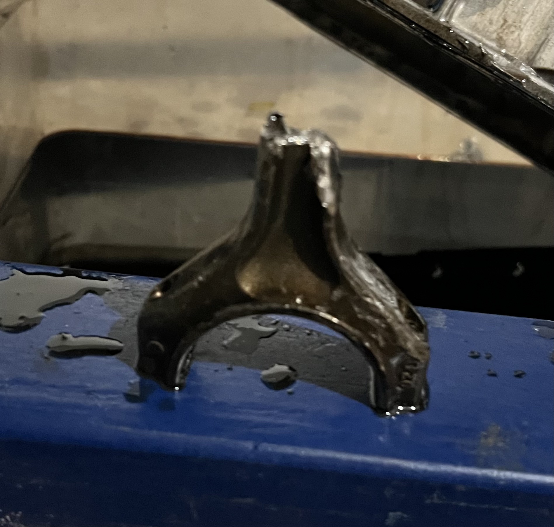

Well, that was the culprit, that's the bottom half of cylinder 1's connecting rod. The bearing cap broke in half and split the connecting rod, which shot itself into the oil pump, breaking the chain, and broke through the oil pan and the block itself. Pretty gnarly.
