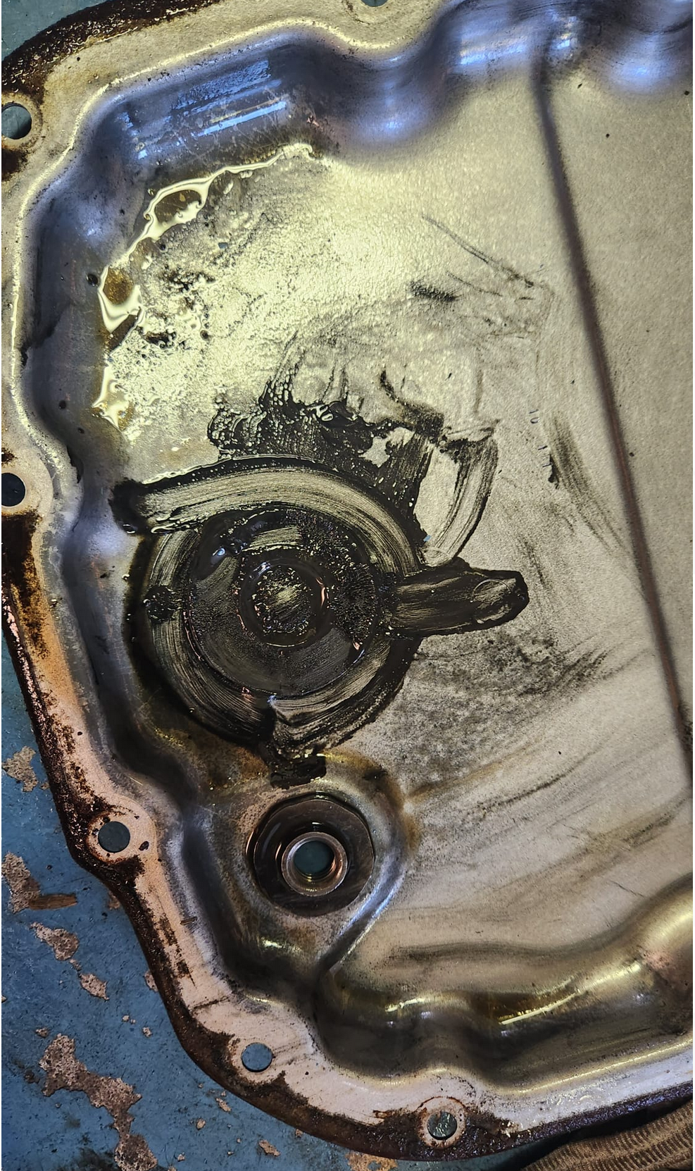

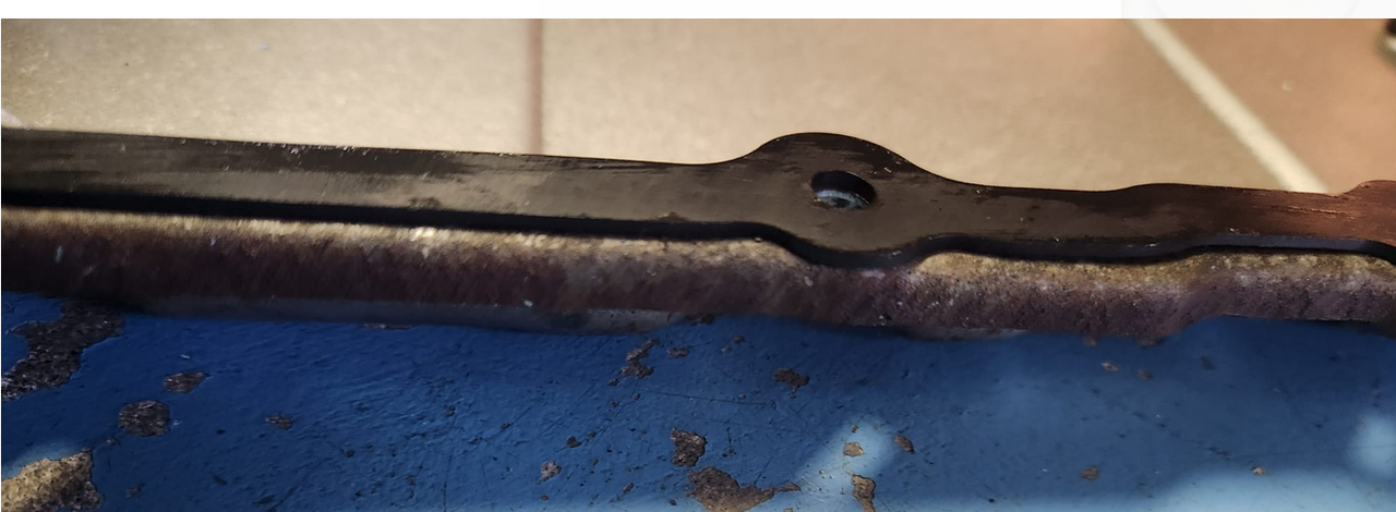

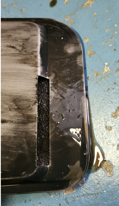

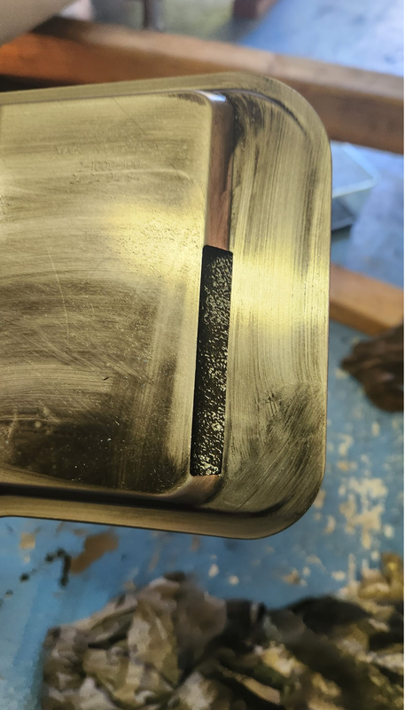

Lightbulb finally i pulled the trigger and changed the oil
there is definitely improvements in jerks, like 75% less jerks.
i only changed oil and filter
Gear shifts have become now fading shift not jerky
i measured the total amount of oil which came out and put same amount and at the same time, i over filled it until it started dripping.
the only concern i have is gasket which came with kit, it not like OEM i hope its ok though i have put it already:/
how do I reset transmission adaptations on this? is it only by inpa or there is a manual procedure as well?
| Model 323i U1 | Year 2011 SEDAN | Development Code E90 (MUE) | Type PG77 | Miles 95000

My fluid was pretty dirty, but that gasket doesn't look great ...
Hopefully it doesn't leak
