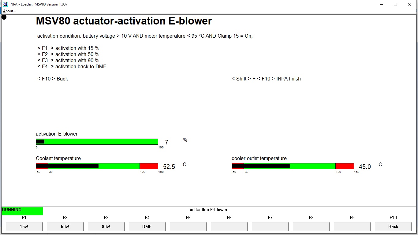

To Activate the Fan using INPA:
INPA > DME (Engine | MSV80 for N52K) > F6 Activations > F1 Activations Group 1 > F2 E-Fan (Choose between 15%, 50% or 90%).
The reason a proper replacement is so expensive is that the Control Electronics for the Fan unit (to run at different speeds) are incorporated in the Fan Unit. So spend some time doing proper testing (AFTER you identify your VIN so I can provide correct wiring diagrams from ISTA), rather than throwing parts.

I was able to activate the fan via INPA through all the power levels (I think it was 15%, 50%, and 90%).

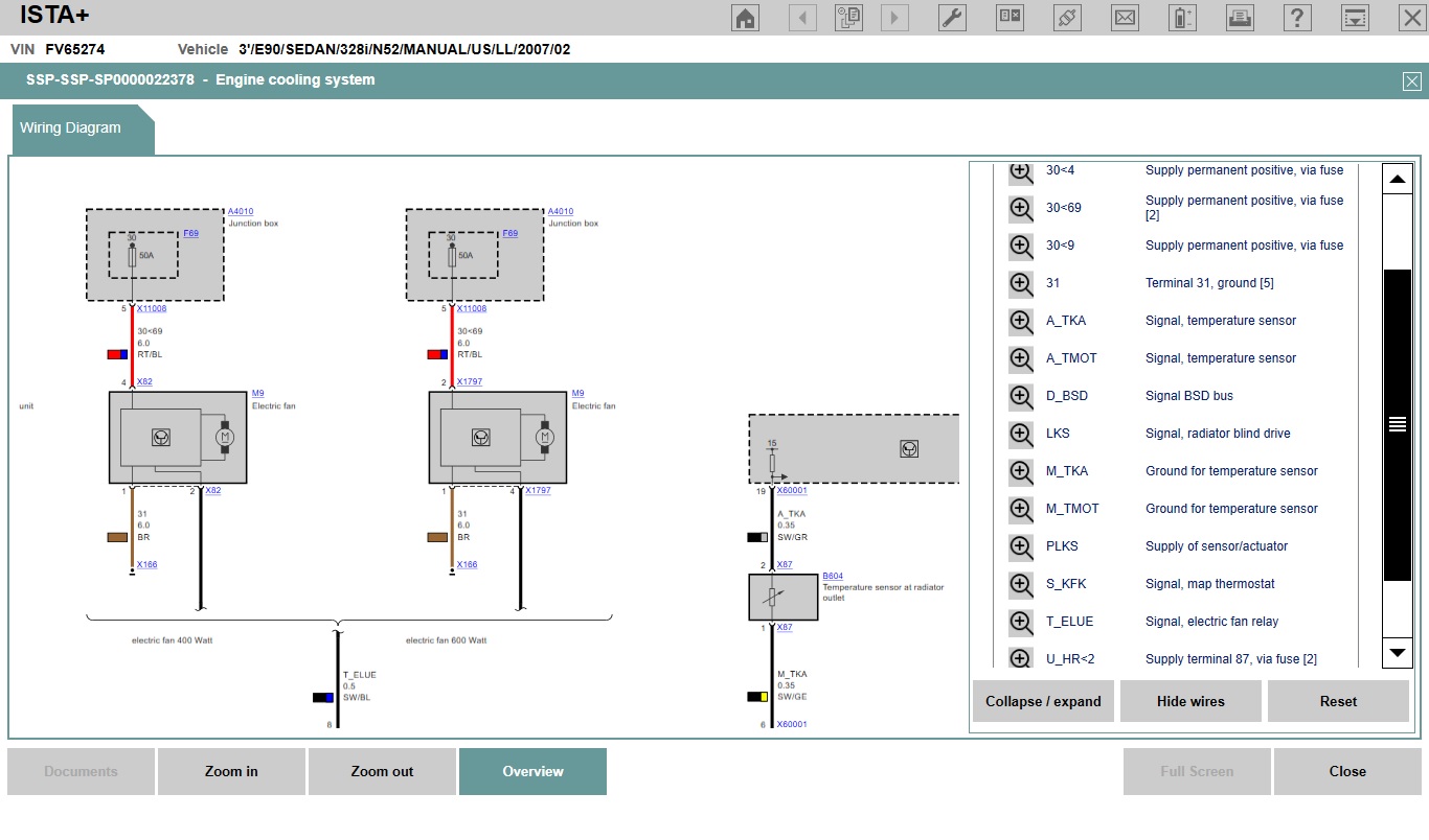

NO Relay on 2/2007 build E9x models:
The relay is located in Models built a Month AFTER yours. I'll attach an ISTA ScreenPrint of the Engine Cooling System, showing the E-Fan circuit that has NO "Cut-out Relay". The cutout relay was used in models built AFTER 3/1/2007, to allow the Fan to run for a minute or two AFTER engine shutdown. My 3/14/2007 build 328xi has that relay, but I have NEVER heard the E-fan run after engine shutdown, so don't feel like you're missing something. It MIGHT be valuable on the N54.
Fan Electronics and Speed Signal Wiring OK:
The "T_ELUE" Line (Black/Blue wire) is the speed signal that tells the Fan when to run, and HOW Fast. Note the ISTA Lines ID Description says: "Signal, electric fan relay", BUT there is NO relay. The "Signal" is likely a PWM signal (Pulse Width Modulated), and as the Duty Cycle or Frequency increases, the Fan runs at a speed based upon that "Signal Frequency".
If the Actual Speed of the E-Fan approximates the 15%, 50% or 90% Activation Speed when Activated using INPA > F6 > F1 > F2, then the fan is working properly. BTW, you can use that "F6 > F1 > F2 Activation" Screen to simply VIEW/ Observe operation of Fan and ECTS Temp Signal as received by the DME. You just open the screen but do NOT select F1 - F3 to over-ride DME Control of Fan Speed (15%, 50% or 90%). Other "Activation" screens are similar, such as Coolant Pump, T-Stat, etc.
NOTE: that on 328i/xi with N52 engine, there is NO ROTS (Radiator Outlet Temp Sensor) on the Bottom Radiator Hose. The DME Calculates the ROTS signal as ALWAYS 7.5C LESS than the ECTS (Engine Coolant Temp Sensor) Signal. So make sure your ECTS Actual Temp is what is shown in the INPA Screen. If you have an Infrared Thermometer, just point it at the ECTS on the front of the OFH, and see if the temp reading/ signal correlate.
You can use that SAME INPA screen to see if/when the Fan begins to run, at what ECTS Temp, and at WHAT speed, with A/C turned OFF. The following is an excerpt from Bentley Manual 170-3, pdf page 356, , describing INPUTS used by DME to control E-Fan:

Attached are ScreenPrints, ISTA & INPA, as referenced in prior post.
