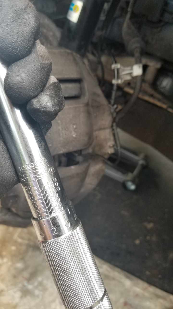

Never thought it would be the Akebono brake pads...especially since they are new. But I will do a front pad swap this week after work and return to the BMW OEM pads that I took off. They are used but still have plenty of life left.
If that doesn't work tie rods, end links, then control arms.
I did not install the springs/struts/shocks. The previous owner installed that at the dealership when the car had 80k miles on it. For all 4 corners.
I'll recheck my torque and report back. I also emailed Akebono.
