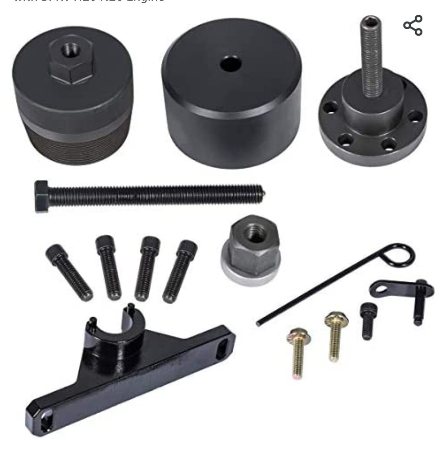

So my belt slipped a while back and a lil bit got pulled into crankshaft seal. I got everything out but left it alone for a while because it was winter and I was ok with the lil bit of oil leak til spring, turned out to be a huge oil leak hense the dirty filthy bay. So I tried to tackle it today and this is what is happening. The seal had no surface for the tool to screw Into. And all that is remaining is the litter lining. Which I believe is aluminum or tin. Tried the puller but that's not working either. Any ideas on how to tackle this. It seems to be really stuck in there. Ordered another puller that looks like it may work or fail miserably. But won't be here til Fri. Has anyone had this happen before?

Order this one instead. Hopefully it'll work. Has anyone ever used this one and failed? If so how did it fail?

Is that puller threaded on the left piece? That's what my shop had to use to remove my crank seal in my 335i after it ate a belt. You should have better luck with it. I would highly recommend you at least get the valve cover off to look in the engine. My engine had belt material inside the oil pan and around the oil pump chain.

Yes. It's threaded should be the better option from all. I see its gripping to be alot more effective.

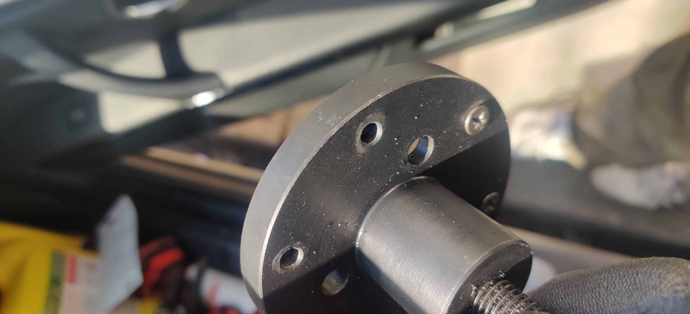

Ok. So this came today. Gonna tackle the seal tomorrow, shifting finger crossed.

The only tool anyone should be using for the crankshaft seal. No matter what condition it's in. I struggle for HOURS with the other puller with absolutely not success. I literally was don't in 3 minutes tops with this new puller.
