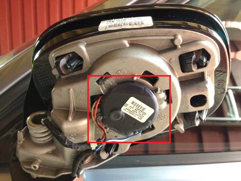

5. Now you can move a bit higher up (electrically speaking). Disconnect the LIN bus controller that sits on three clips on the mirror assembly. Picture attached. Connect the ground test lead of multimeter to somewhere in the car (typically the door hinge). Then test each connector pin of the LIN bus controller (8 pins in total I think) with the positive (red) test lead. By operating the mirror glass direction switch. Not all pins may show a signal. For me, the one's that show signal switched between 12V and around 3V when the driver switch was operated. I'm still looking for more info on what each pin is for. So I know exactly what each pin should react on inputs from driver.
