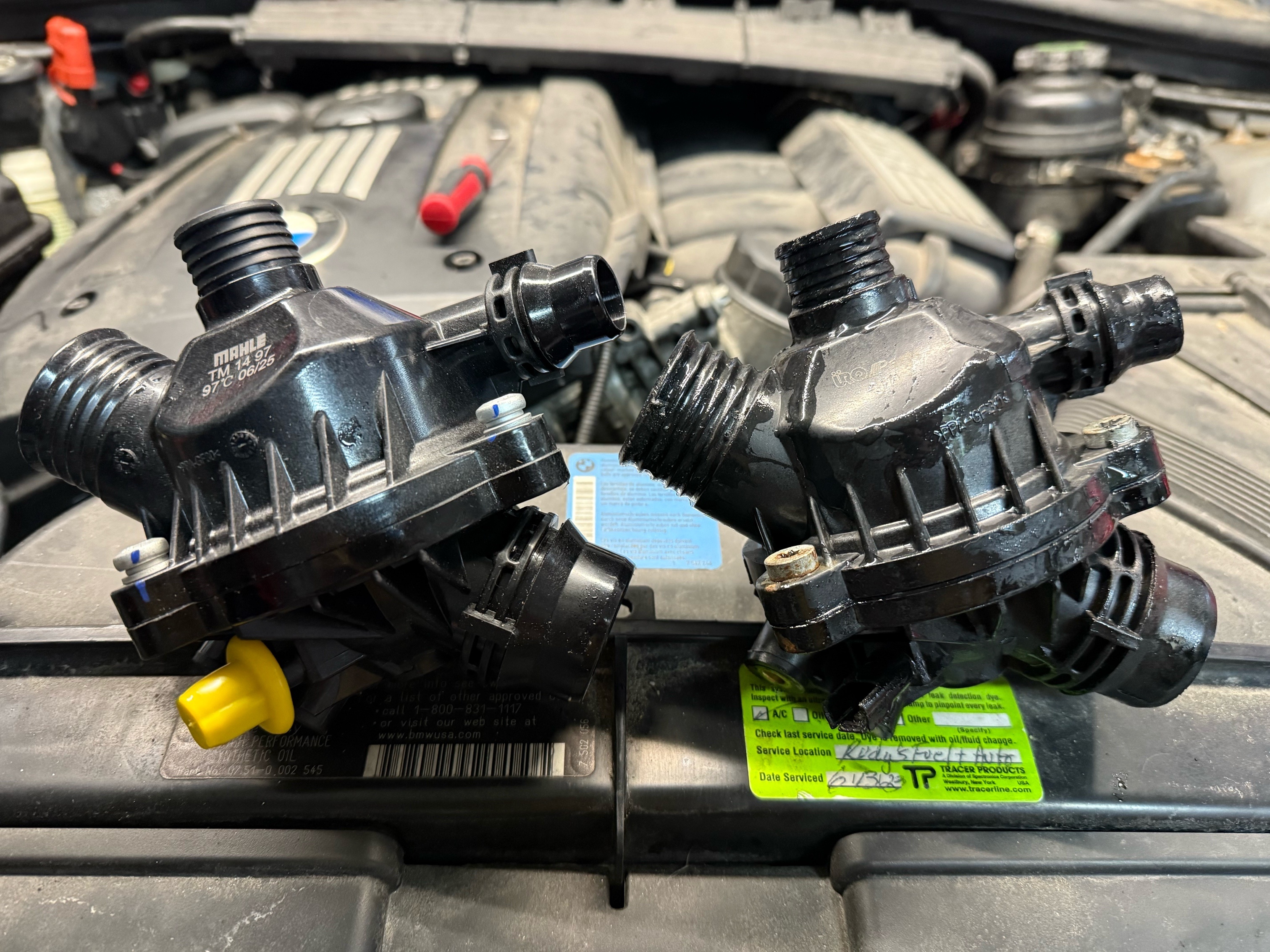

My 2010 BMW 328xi is doing the same thing. Thermostat was replaced by previous owner within the last 3,500 miles. Finding when I purchased the car that it was not coming up to proper temperature (and that I didn't have heat while driving), I replaced the thermostat... no improvement. I've read versions of this story in varoius places, but don't see a solution. This car also got a new water pump and radiator at the same time as the thermostat replacement (3,500 miles ago).
Everything points to thermostat, but it seems it's got to be something else. Has anyone found the solution to this problem?
      02-04-2026, 07:33 PM   #15
okon2
Drives: 2010 BMW 328xi
Join Date: Feb 2026
Location: Michigan
Could it be a bad coolant temperature sensor?
      02-04-2026, 07:40 PM   #16
NZE90
499
760
Drives: 325i
Join Date: Nov 2022
Location: Straya
Was it an Aliexpress thermostat?
      02-05-2026, 11:36 AM   #17
okon2
Join Date: Feb 2026
Location: Michigan
No, it was a BMW Thermostat Assembly - Mahle Behr part# 11537549476
I suspect now that the “old” one is actually functioning properly, but I didn’t test it. I did the BMW coolant bleeding procedure (twice)
(I also replaced the oil filter housing gasket, which was leaking oil)
Same issue persists. Code 2EF4 showing again.
On heater core hoses, inlet is hot at idle, outlet is warm to hot.
Immediately after driving, inlet is warm - hot, outlet is cool
Sunday (February 1st)
Wondering if there was an air pocket in the heater core, I drained the coolant again and did a vacuum fill procedure. The indicator held -16 on the dial for several minutes before I opened the coolant suction valve.
I topped off the coolant, did the BMW bleed procedure, drove it, same issue persists. I did the BMW bleed procedure two more times (with 20 minutes in between), same issue.
At this point, I am wondering / guessing / reading that it may need a reverse flush of the heater core?

Here are images of new thermostat, and both side by side
