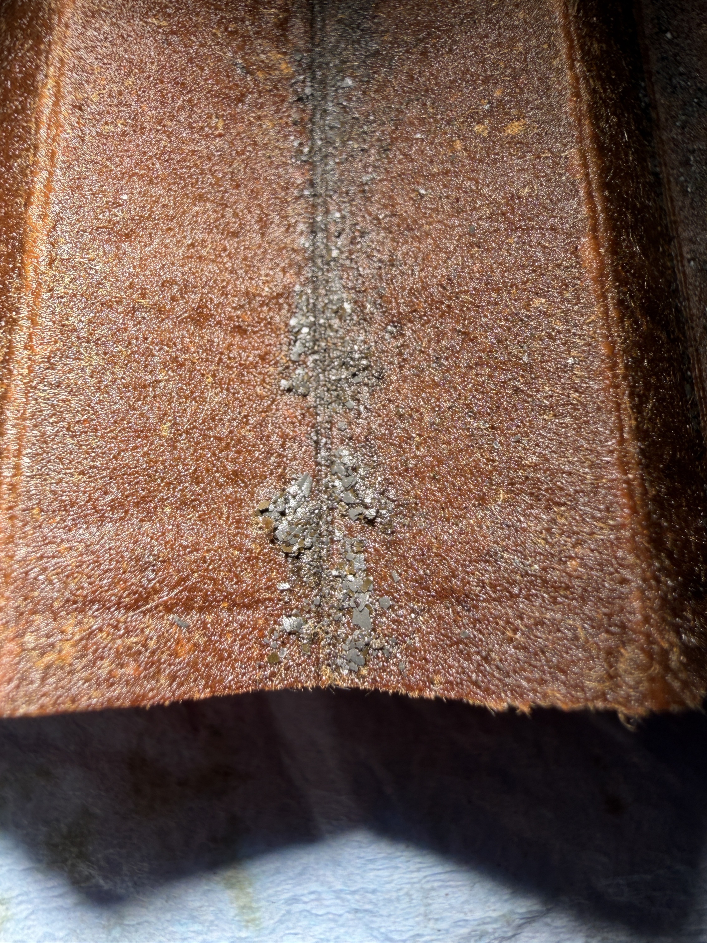

UPDATE: I just did my oil FILTER change at 5330km. (Little late I know sorry) Quite a bit more meterial since the first post when I started this thread.
By the way: I’m running castrol euro formula 0W-40. For winter
I have a few varying factors that may have played a part in the larger amount of material.
  1. The outside temperature here in Alberta is quite a lot colder this time of year and the car sits outside. Basically always below 0° C or 32°F. Sometimes -20° C or -4° F or colder. I kinda doubt this makes a difference but who knows.
  2. I just recently went on a 7 hour round trip on a long highway where the car saw steady state 3k RPM for all 600+ kilometres (130 kph). this I would say played a pretty significant part sitting at high oil temps and moderate RPM for long periods of time may have put more meterial in the filter.
Other than that normal driving or same as what I described in my first post.
Apart from those variables the material in the oil filter is practically identical to my original post. Nothing in the filter is magnetic and it’s all those grey/brown flakes.
Now I will say it appears as if these flakes have a grey side and a brown side almost as if the grey side was the portion attached to some surface in the engine. And the brown side is oil staining. Like a crust flacking off somewhere. Now why it is deciding to flake off now, I have no idea.
And I will be continuing to drive to 10k km on this oil to see a second half comparison. I have a suspicion it will be no different but who knows that’s why im doing this.
Otherwise absolutely ZERO difference in engine noise, performance, smoothness. Etc which tells me and is proved by the pictures the filter is doing its job.
For reference car has 342,776km and is a N52B25 not a 3 liter but obviously others have had it on 3 liters as well.

Thanks for the update.
Definitely looks like a coating flaking off the inside of the engine somewhere.
When I changed my oil pan gasket I didn’t notice loads of flakes in the pan at 250kkm
You’d think a coating would flake off in big chunks and be in the pan and blocking the oil pump pick up, but that wasn’t the case for me. Unless the problem only begins at around 300kkm
We really need someone with the grey flakes in the filter to do an oil pan gasket change and fully inspect inside the bottom of the engine

I did an oil pan gasket change at around 280k km and same here noticed nothing out of the ordinary and the pickup was perfectly clean. But I also don’t recall noticing flakes in the filter at that mileage. but I do agree it needs to be done on a car with the problem actively occurring.
I also found it interesting that there was no trace of these flakes on the vanos filters now I’d presume that the oil is filtered prior to those filters. but you’d think if the oil passages also had this coating or build up that has deteriorated over the years you’d find some on the vanos filters post filtration. But I’ve found non, possibly because the oil is under too much pressure and is flowing at a high enough rate that it cannot accumulate this material there. Which would make me think that this material only occurs, whether it’s a build up of something or a layer peeling off in low pressure areas like where oil stagnates.
Again all theory but it’s something to ponder on.
I may have to do a valve cover this year so if I do I’ll post pictures etc.
