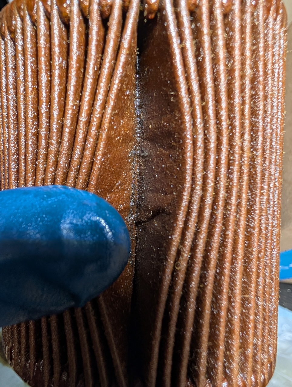

Jumping in with some more anecdotes.
A friend and I installed a junkyard N52 with ~60k miles that was in great looking shape...except it had flaking in the block identical to the image Hakentt shared on the first page.
We thought it was odd, but ultimately did nothing. Well that engine ended up spinning a bearing in less than a thousand miles, and the oil filter was totally full of those flakes. My take is that the flakes killed that motor.
I just did a 3k oil change today on my N52 with 190k on it, and I see very similar detritus as the OP. Is it possible these are also the same flakes, but coming off incrementally instead of all at once?
Hoping this data point helps us figure out the pattern as a community
That looks like sludge that is being filtered out to me. I want to give you some interesting anecdotal information as well. My N54 engine also has sludge flakes that I find in the filter every oil change. My car is pretty heavily tuned and I run E85 fuels daily. It gets run HARD every day so its just part of life for this engine.
What is interesting though... is that the N54 is an all aluminum construction, no magnesium whatsoever in the engine block or rotating assembly. So the theory that is a special coating because its magnesium that is coming off just doesn't add up. I find it more likely that its simply sluge that builds up in low oil flow areas that eventually come off.
Something we do need to keep in mind is that oil flows directly from the oil pickup tube, directly to to pump and gets passed thru the oil filter BEFORE it touches any rotating assemblies or other lubricated parts. As far as I have seen, nobody has reported a clogged pickup tube (other than the guys that didn't maintain their serpantine belt) and nobody has posted a filter that is completely clogged with debris. Yes there has been some debris in the filters, but that is exactly what the filter is there for, to catch anything larger than let's say 20 microns before it ever reaches the bearings, camshafts, etc.
Edit: Walked outside and took a pic of the filter I changed out of my N54 last week... its been draining/drying for a week. So thats why its drier than the ones you guys have posted.
Appreciate this, and I think in my case, you might be right, the pieces seem smaller than what the OP is sharing. I wish I had the foresight to have taken photos on that 60k engine I installed, but the flakes visible with the pan off were identical to the photo Hakentt shared and what was shared here: https://bobistheoilguy.com/forums/th...filter.375728/
Further, when the 60k motor spun a bearing, the filter was clogged with debris. Again, I 100% should have taken a photo of that.
Here's someone that has a lot of these flakes: https://www.bimmerfest.com/threads/b...view=1#replies
Curious to see what I find when I drop my pan to do the oil pan gasket.
One theory I have is that it was somehow caused in the 60k motor because that motor had sat for years after being pulled, and maybe moisture was some catalyst here. Perhaps this isn't a concern in vehicles that are run regularly.
Or perhaps this is still some external substance like stop-leak that was introduced to the system. I just think it's weird that the flakes look the same every time, and seem somewhat N52 specific.
