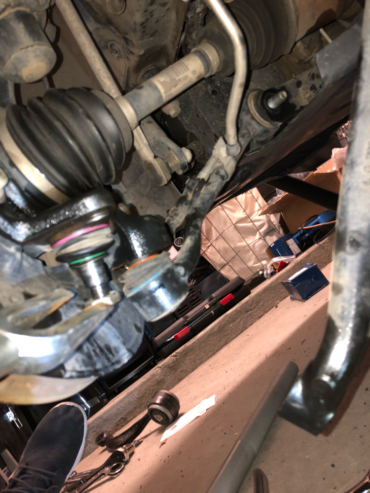

So to at least humor people. I'm doing this tomorrow am. I have the control arms loose and hanging down but need to pop them off then I can start on this fun stuff.
^Short cut to 1:43
Here is a video that better shows sort of what it will look like under there. You can conveiently see in the video they edited out the HELLL it takes to get it out. i found that to be pretty funny. With their editing magic it just took a few tappa tappa tappas with a hammer to pop out.

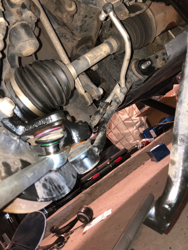

Done!
It stumped me for a while but once I got one side done the other side came out in about 10 minutes.
I recommend putting the nut back on the ball joint (they usually give you a new one anyway) and using a separator tool to wedge in and leverage the bolt against where the thrust arm is on the spindle. Hammering it in and then hammering down on the end of the tool a few times created a lot of downward pressure sort of like a slide hammer. Eventually you will see a gap start to spread, a couple more times and it popped out or you could try to wedge the tool in the gap and go after it that way.
The night before I soaked the top of the ball joint in corrosion x spray , maybe that helped. I've used it before on guns and it spreads like crazy and starts to eat the rust away. Welp, never doing that again. Hopefully that helps someone next time.

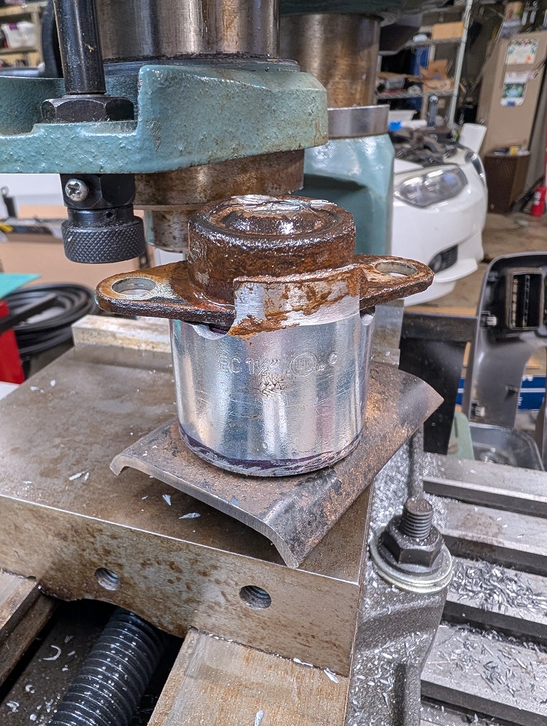

Yes, I know this is an old thread but it's been very helpful to me so I thought I'd share my home-made tool to extract the ball joint from the upright. I saw the crunchysann tool, but only after I was half-way into the job; plus I'm cheap so I made my own. Nothing had worked for me (sledge on top, slide hammer, air hammer on top ...) until I made this tool and used it with a big impact.
I used a 1-1/2" IMC electrical conduit coupling from Lowes, similar to the oval threaded pipe nipple in another thread but easier to fit IMHO. Lowes P/N 24661 or Rigid Sigma P/N 02-55084.
Use a cut-off wheel to make two cut-outs as shown in the pics. These will go around the ears of the ball joint, use the new BJ to mark where you need to cut. One side has to be slightly ground on the OD to fit into the narrow space between the BJ flange and the as-cast portion of the upright. Again, see pics.
For the flat 'top' I cut up an old lawnmower blade (!) but it worked well. Right thickness, right hole diameter, and built-in rolled edges for increased stiffness. Your mower blade probably needs to be replaced anyway!
You may have to adjust the length of the fitting slightly to get the nut started. (I did, with a bench grinder, being careful to keep it as flat as possible).
Make sure to use grease or anti-seize on the nut, washer and flat plate. Had to use my biggest impact on the nut. Pic shows the extracted BJ I pounded on, but the other side came out right away, no need to remove the caliper for pounding clearance.
Finally, when it starts to move, stop and add washers if needed. Otherwise you can (like I did the first time) end up jamming the nut onto the stud, and the Torx bit was not up to the task of counter-holding to remove the nut. I had to cut the nut off, but lesson learned.
Hope this is helpful
