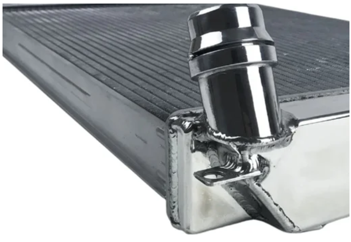

Okay, two updates...
  1. During removal and inspection of the old radiator, I discovered that the plastic end-tanks had not cracked or separated from the core at the seams, as is usually the case. Instead, the coolant must have frozen at some point because the cooling tubes had ballooned from the inside and buckled, causing microscopic cracks in one of the tubes and distortion of the entire radiator body. That is not the fault of the radiator, and ANY brand (or type) of radiator would suffer the same fate with frozen coolant. Make sure to use proper BMW coolant, mixed 50/50 with distilled water. Over-dilution with distilled water can lead to frozen coolant and potential damage throughout the engine.
  2. The all-aluminum replacement radiator is a work of art and seemed so promising, but turned out to be a bust. All four of its mounting points will not engage in the radiator mounting shroud, leaving the radiator about 15mm closer to the engine (over 1/2"). Even if it were possible to fabricate stand-offs to accommodate that gap, the fan would crash into the oil cooler lines mounted to the oil filter housing on the N54 engine and airflow through the A/C core would not be as efficient because of the huge gaps.
    With a bit of grinding, I was able to modify the two lower mounting brackets and one of the upper mounting brackets to engage well enough with the radiator mount, but the fourth, upper mount, is impossible to fix because the end-tank itself hits the radiator mount. The plastic end-tanks have a large indentation to accommodate the radiator mount in that area, whereas the aluminum tank is square at the top and completely ignores the need for clearance. (See photo).

Bummer! That is the eBay radiator you mentioned?
Digging up FCP Euro's CSF 7046 (for N54/N55), looks like it is a tight fit, a couple of reviews mentioned of wiggling to get it in, but others said it fit right in. Maybe CSF is still the one to go?
Overcooling seems to be the problem with CSF. Apparently BMW's thermostat design cannot seem to handle it, maybe German winters are warmer than we thought.
https://www.fcpeuro.com/products/bmw...f-7046#reviews
Also, here is FCP's CSF 7046 install video. At 27:00 the forward tabs should engage the slots in the radiator mounting frame. At 27:15 he talked about how the lower feet should sit or else the screws and fan shroud will not align properly. Maybe this will help some.
Also, here is FCP's CSF 7046 install video. At 27:10 he talked about how the lower feet should sit or else the screws and fan shroud will not align properly. Maybe this will help some.
Yes, mine is the eBay radiator. I checked out the FCP Euro installation video, and there are fundamental differences with the mounting points on the CSF radiator. There was no way that the eBay radiator would go in because of several reasons...
FIRSTLY, its mounting feet are designed differently, and they're far too wide to fit into the plastic channels of the radiator mount. So I ground down the feet to half their width until they were narrow enough to slip into the mount and they finally located properly, but then...
SECONDLY, the top tab (on my left) is incorrectly designed with insufficient clearance for the A/C lines. This is easily verified by comparing the plastic radiator with the eBay radiator. So I ground that tab and got the clearance I needed around those lines. Then the top of the radiator moved closer to where it should be, but then, BAM!...
THIRDLY, the tank itself (on my right) hits the top of the radiator mount. Baffled, I checked the CSF video again and noticed that the CSF has a different design at the top of the tank. The tank itself is angled to clear that mounting area. (See the photo below). The eBay radiator does not have that 45-degree angled tank. It's square. (See the picture in my last post), and it solidly hits the radiator mount with no way around it, except to cut and weld the tank like the CSF radiator. Not gonna happen.

Yeah that top corner is the deal breaker. CSF got its complaints but the eBay price is just too good to be true.

Sad but true. BMW has designed the complex shapes on this radiator and its mounting shroud to fit together like a glove. It would be really difficult to design a metal radiator to fit without issues. Even if the design was perfect, the fabrication can fail because aluminum buckles during welding, so the mounting locations can turn out different from one radiator to the next.
Sure, the mounting shroud could be butchered and modified to make this fit, but I'm not prepared to go to those lengths. I'd rather keep it closer to stock.
Note that this same aluminum radiator is available on eBay, Amazon and a few other places, so be careful not to get caught, people! I've ordered the Nissens radiator (made in Slovakia) from FCP Euro instead. Of course, it's plastic, so we'll see how long that lasts, but so far, the reviews are looking good...
