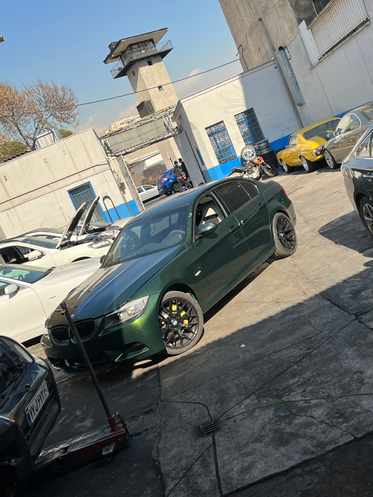

Today we started finishing the bodywork. So far it looks great!
Biginboca3864.50
Buug95930766.00
fazm653.00
Wolf 3352593.50
      01-01-2022, 01:26 PM   #56
jacbo
82
270
Drives: E90 330d LCI
Join Date: Sep 2020
Location: Cheshire
that colour is amazing.

Nearly done!
3PedalJake3520.00
jacbo81.50
fazm653.00
      01-13-2022, 06:53 AM   #63
NGEE
Fuck it dude, let's go bowling.
NGEE's Avatar
989
2,521
Drives: E82 1M, E21 320i
Join Date: Jan 2011
Location: Not Massachusetts
Originally Posted by sam_ssr View Post
Nearly done!
That's fantastic. Loving that Chevelle also!

I 53rd the color compliment lol.. but really the color is awesome!

Can you show us your seats some more? Those are hot. Car looks amazing.
