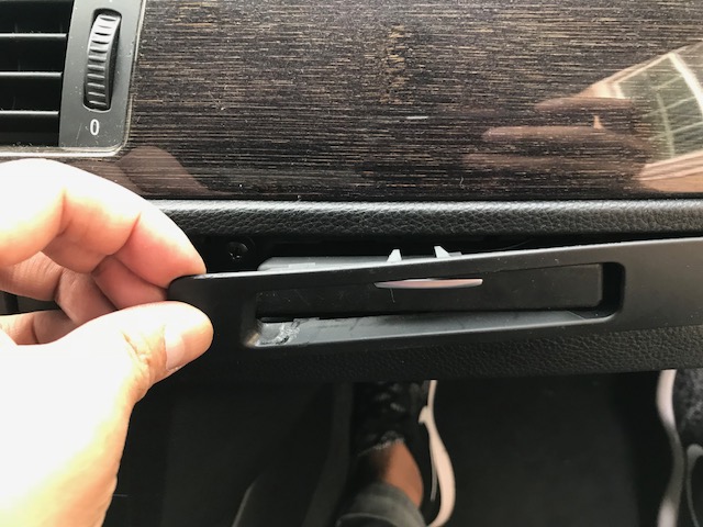

1. Per ctuna's reply on this string (#14, line 4a), remove the bottom panel below the glove box.
2. Remove both cup-holders above the glove box. This is necessary for the glovebox to pull out (next step). You'll need to pop out the plastic trim around the cup-holders. Use a plastic prying tool if you have one, otherwise a flathead screwdriver will work - just be very careful not to scratch the trim or your dash. It should give easily; just pop one side and pull the rest out gently with your fingers. There should be 4 screws. After taking them out, the cup-holders should pull right out.

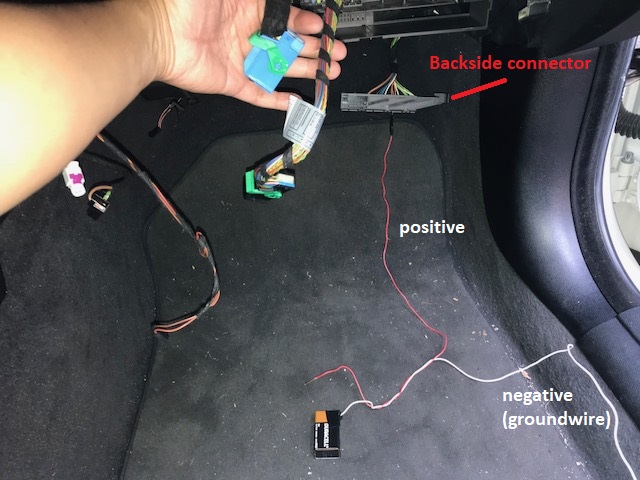

4. Disconnect the junction box. First, disconnect the two wire connectors facing you (one blue and one black) and secure them out of your way. Next, there are 2 screws on the left and the right of the plastic "sleeve" holding the junction box secure. After you unscrew them, there's a plastic tab on the top of the box near the left screw. You'll have to feel around and press it down to unsecure the box and be able to pull it out. Note: You shouldn't be able to pull it all the way out - nor should you just yet.
5. Once you have the junction box loose, disconnect the wire connector behind it. This is the trickiest part. On the far right (as you face it from the seat) on the back of the box is a tab. Slide it all the way out to the right. It might take firm force at first. That should cause the connector to pull away from the box. And there you have it! That connector is the Grail. Pull out the junction box completely and set it aside.

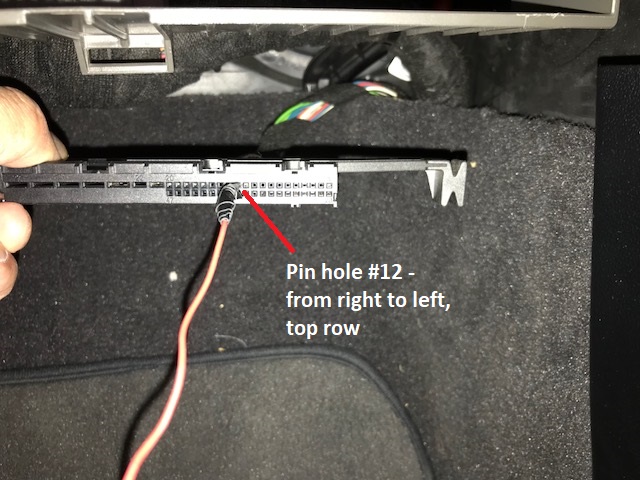

6. Locate the correct pin hole (pin #12) on the connector for the trunk release. You'll notice the junction box has corresponding pins to send electric signals down these small square holes. On the connector, you'll notice the top row of holes has a "1" on the far right, and a "20" on the far left. Just count right-to-left to the 12th hole in the top row. On the other side, you should see the infamous grey wire with a green stripe. It's almost dead-middle of the connector.
7. Send a small electric current down this hole. I used a 9-volt battery and thin radio wire (usu. 2 very thin intertwined wires with a red and a white insulation for positive and negative respectively). To ground it, I wired the negative lead of the battery to a small clamp (with my white wire) and attached the clamp to the passenger seat rail. Now, I was paranoid here not to let your positive and negative wires touch each other or the same piece of metal for fear of shorting or burning something out. It's just a 9-volt battery, but better safe than sorry. Next, before attaching the other (red) wire to anything, I stripped about an inch of insulation off one end and shaved the wire thinner with a knife. You should then be able to slide that end of the (red) wire into pinhole 12. Be careful and don't force it; you don't want to end up with a broken piece of wire jammed into that hole. Once that end of the (red) wire is secured into pinhole 12, just brush the other end of it against the positive lead of the battery.
If all goes well, you should hear the beautiful sound of your trunk latch releasing and a weight of embarrassment (for getting yourself into this mess) lift from your shoulders.

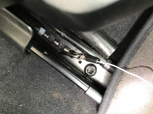

      05-14-2018, 03:24 PM   #27
Pladi
Pladi's Avatar

nadidlab, If the trunk release actuator wire in the harness that goes from the chassis to the trunk/boot lid is broken, neither of emarkus' solutions will work. Regrettably, you must open the trunk to access the wiring harness to effect this rather simple repair.
If (like me) you do not have a trunk key lock, or a ski pass through, or folding rear seats, you are probably (like me) looking for some other way to get into the trunk so you can repair the broken wire in the harness. Good luck.

Hello,
I got stuck with broken cable and closed trunk on my wife's E90 335D with no key hole, no folding seat or "ski sack" in the middle so I was evaluating the Kenobee option above (thanks!) and wanted to drill the hole. Did I say it is my wife's car? Ok, here is the ULTIMATE non destructive recovery if everything else in this thread fails:
- Remove the seat cushion (it's only on two clips)
- Vacuum the kids mess underneath the seat cushion (optional but satisfactory)
- Unhook the passenger lower corner of the rear seat, (you need to put your fingers between the door seal and behind the seat and lift the corner up) it's quite flexible corner so once unhooked you can pull it few inches from the body. I put a wooden block underneath to keep it opened. This will provide you a peephole to see the sexy manual latch. I also removed the two middle bottom torx M10? bolts but it did not show any positive impact on how far the seat can be opened.
- than you need literally fish the latch. After few trials I used my daughters fishing rod as it was flexible - you need to feed it between the front passenger seat and B pillar through the peephole and once clear of the B pillar you need to go up. Other option would be smaller sticks and keep adding and taping them as you push them inside since there is not enough room between the opened rear door and the peephole. You need about 6 feet long object to reach the latch. I'm explaining it too complicated, sorry, once you start you will see it.
- the hook shouldn't be a J shape but rather just an L shape because the latch is clipped to the wall and with the J shape you won't be able to engage the latch.
I hope it helps!
