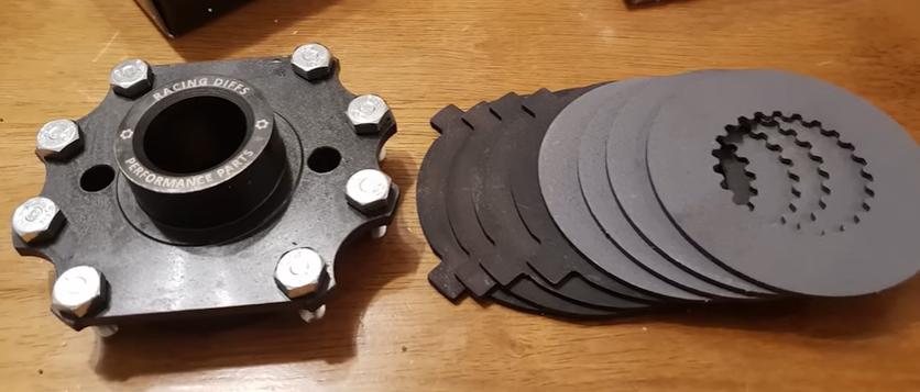

my racingdiffs lsd conversion kit lasted about 2 years ~30k miles before the center pin busted in half. daily driving and autox.
you have to machine down the half shafts a bit. otherwise it's an easy install. in hindsight I wish I would have just gone straight to a legit LSD.

I asked Racingdiffs if any machining was required, they said no. But it could also be just for my model 215LW
Then I fell over this. Love that these muppets are having ago, but doesn't even match mkeiser's experience.

I think my center pin ultimately snapped due to using 200tw tires and hard launches. I bet it would have held up longer with less grippy tires. RacingDiffs support was great when I contacted them about it and they had a replacement center pin I could have purchased, but I ended up putting in an MFactory clutch LSD instead.
Obviously RacingDiffs knows their product more than I do but I would ask for clarification if any modification is required on the axle shafts. I had to do it for my 188L. Looks like it's needed for 215LW based on some videos they have on this page (Look for the 188LW 215LW video towards the bottom).
https://racingdiffs.com/pages/video-gallery
also looks like you can use hand tools...

haha I stopped at 59sec. We would do that shit in construction, but its a little different in the accuracies of a diff connecting volumes of HP and Nm to bitumen at speed.
Do you think his Russian? Honestly to make a video suggesting to hack the end off a spline at perfect 90deg with a grinder. I can see how his product fails. I guess I could do it on the lathe but think racingdiffs has spoken for itself.
To be honest I was surprised at the price of the Mfactory LSD. For some reason I was thinking 5K but it appears to be 1.8. Think really from this discussion its more in my wanna be head, opposed to the reality of my skills. I can zip around the place in the standard just fine. The speeding fines are enough opposed to having it impounded for practicing a drift around a round a bout.
Recall searching for a RacingDiffs video even mentioning the 2 gear grinding some of us require but there wasn't one (how shady).

Don’t do it, check this “long term” review, this guy used that kit and after 8000km, the “clutch packs” were completely worn out and the rear diff went back to acting like an open diff again

Maybe, but 8k (kilometers, or 5000 miles), even beating on it, seems extremely low... Compare an actual clutch pack on a clutch based LSD to the "clutch" that comes with this kit and you should be able to clearly see the issue
