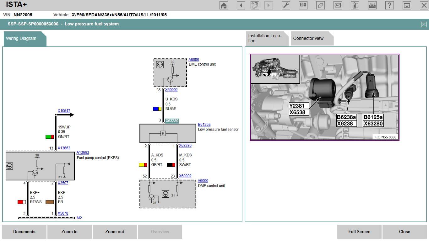

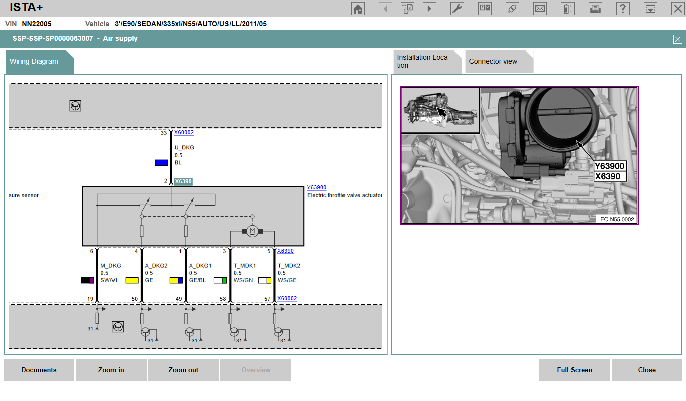

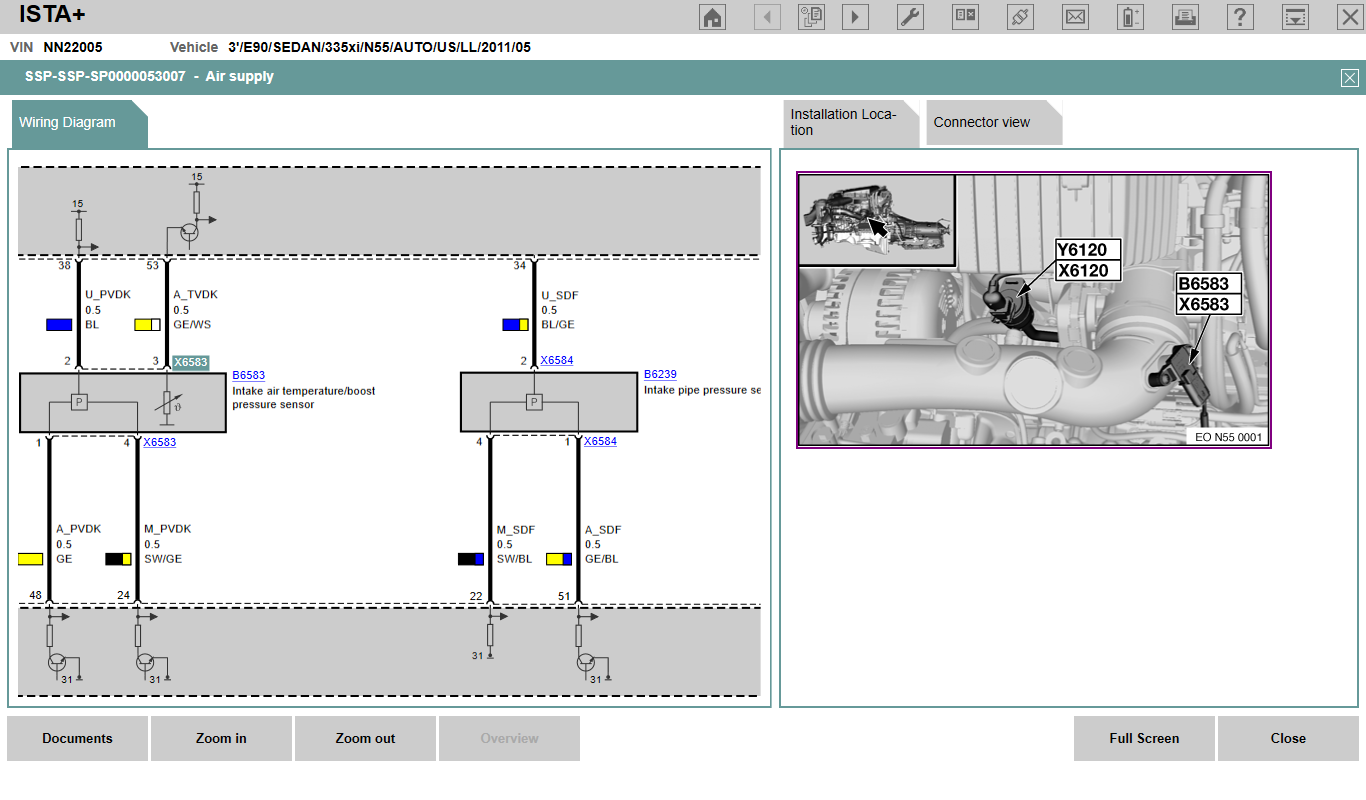

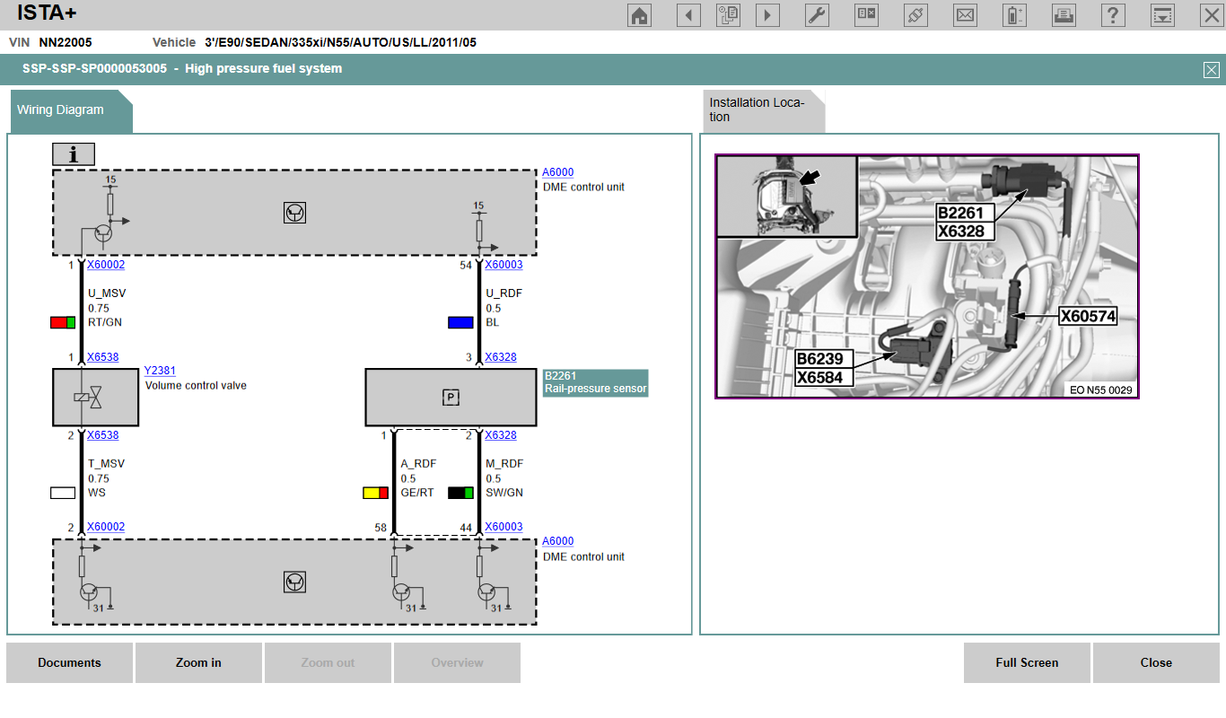

I'm replying to your 2:20PM post (which you changed). You apparently have a major wiring harness "Pinch" where the
harness has been shorted to B+ (possibly at rear of VC or something else you Removed & Reinstalled in that repair.
ALL of the major DME Faults that are Currently Present were saved at 163,152 miles (is that what your Odometer currently
shows?) or 262,568 km.
Attached are ISTA ScreenPrints which show the wiring & location of the Throttle Valve actuator (2 faults), Intake Air Temp &
Boost Pressure Sensor, Intake Pipe Pressure Sensor, Low Fuel Pressure Sensor & Rail High Pressure Sensor. Follow the wiring
from those sensors to the DME, & you should find the pinched wiring harness which is the cause of those "shorts to B+".
I don't have an N55, so can't help with locations of wiring harness. If you need to use "ISTA as Shop Manual" to see wiring,
Connector Locations, or Connector Views, see the attached pdf which explains HOW to do that.
George
