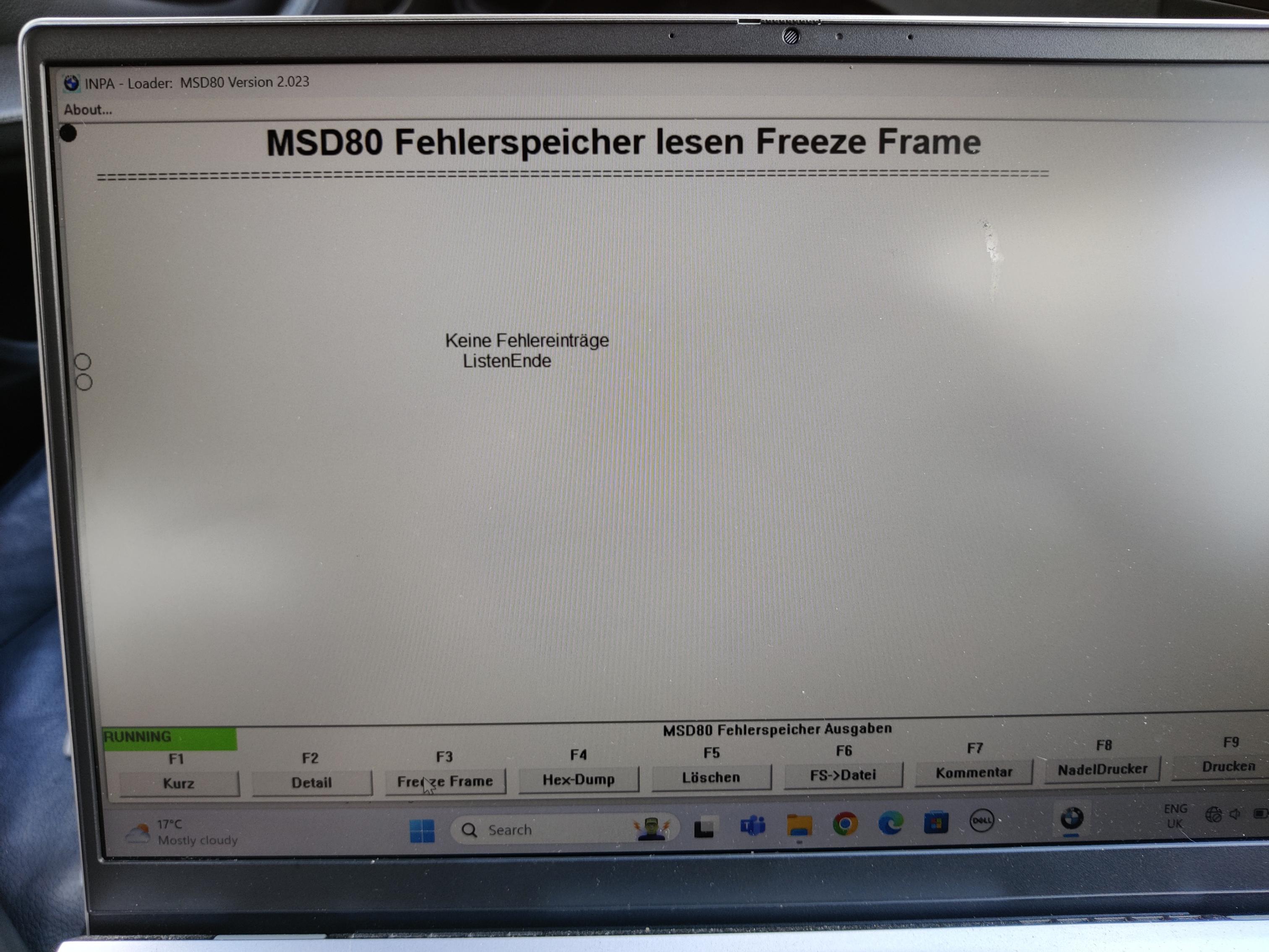

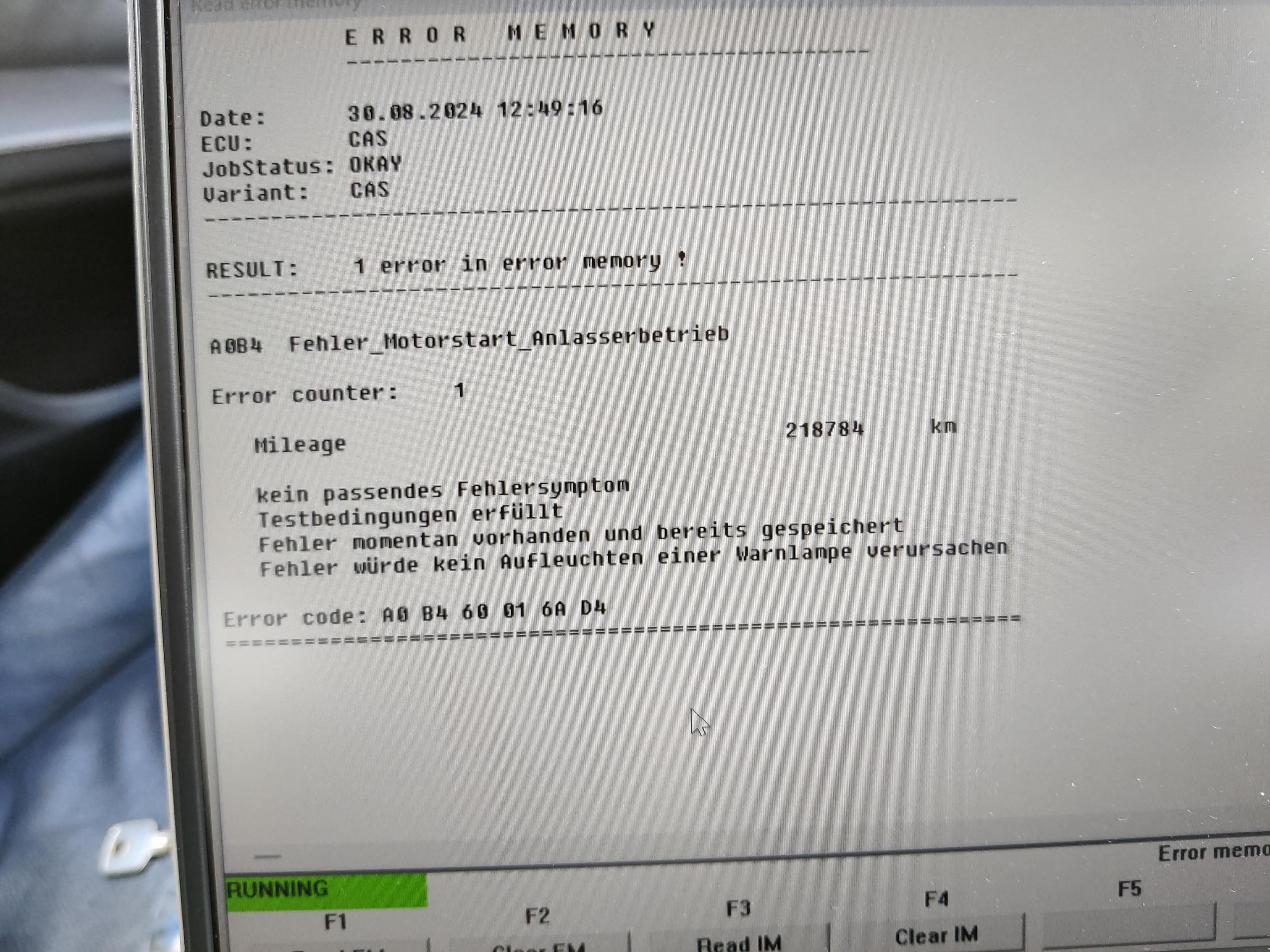

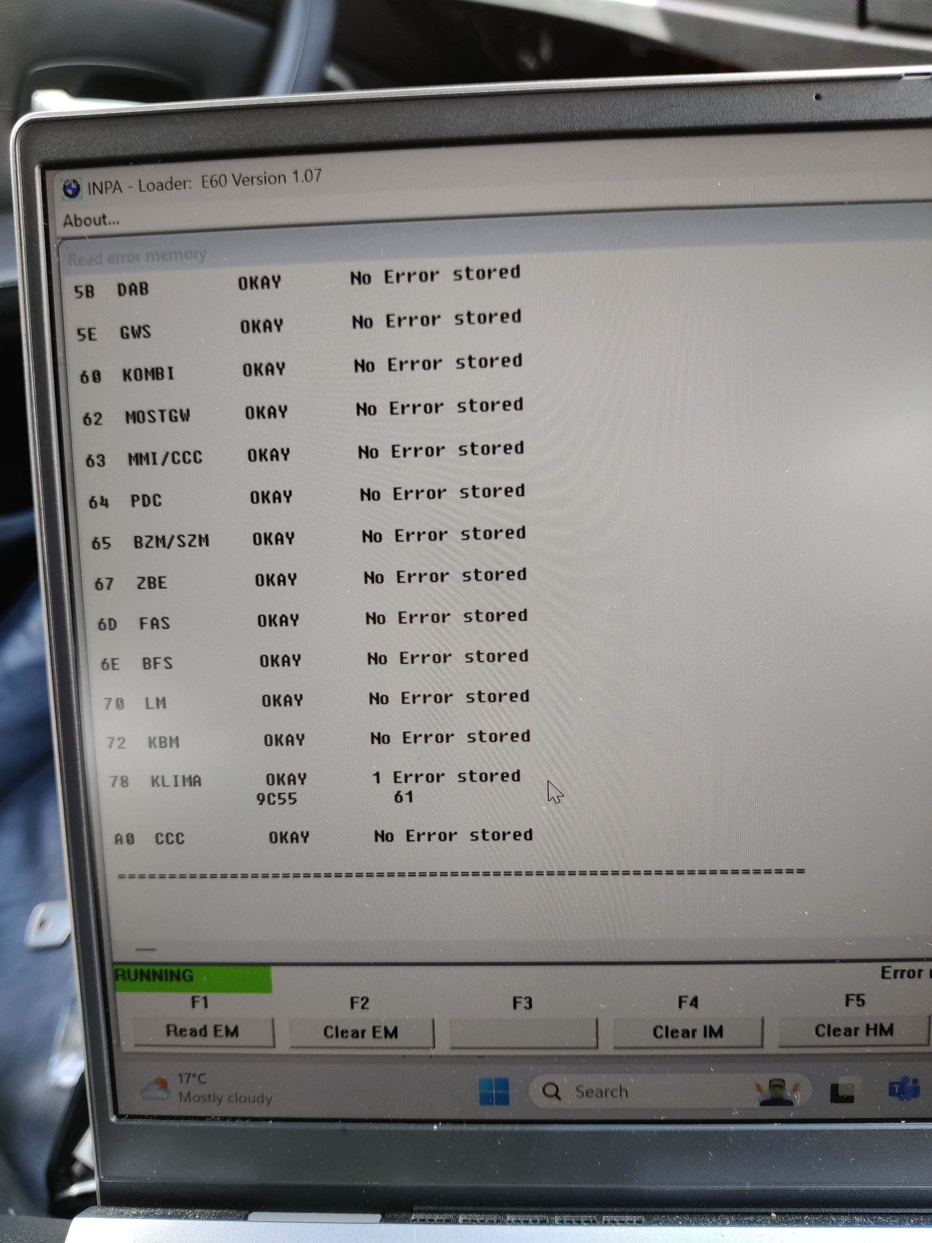

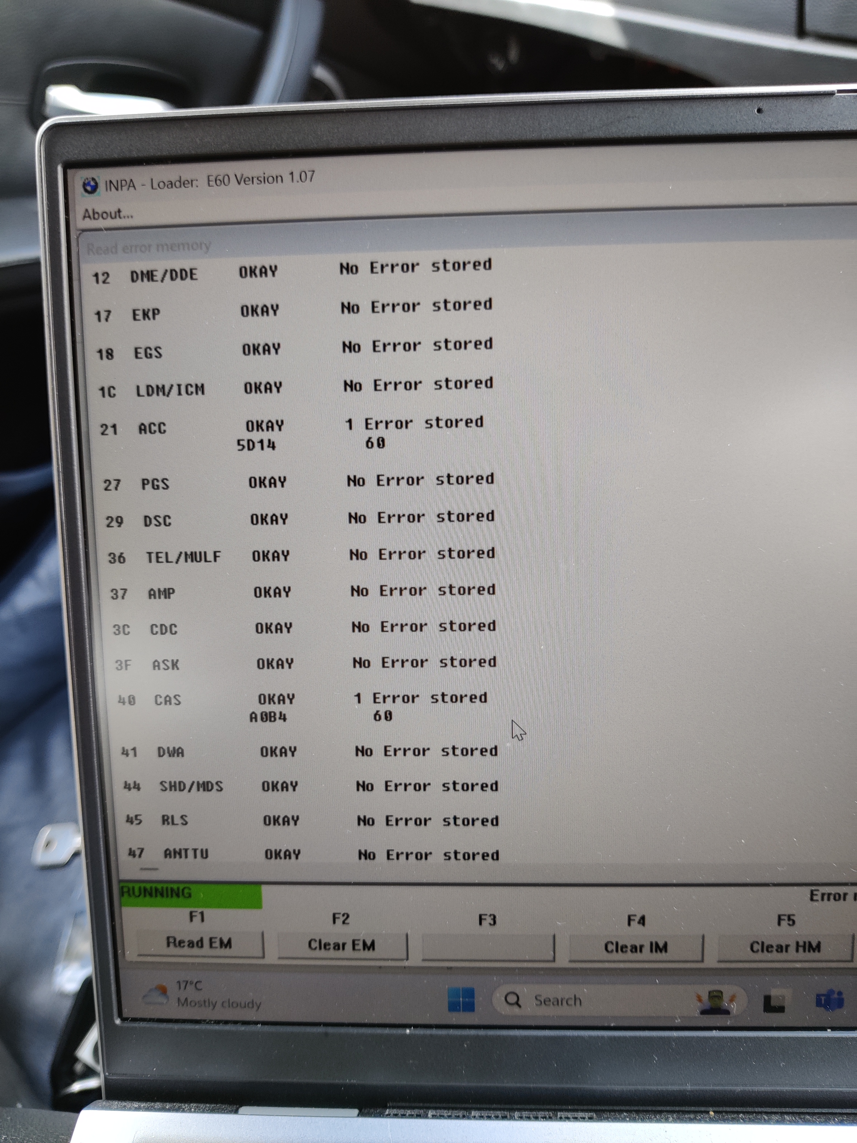

Please attach INPA ScreenPrints of following, per attached pdf:
1) INPA > Functional Jobs > F4 > F1 Fault Memory, ALL Modules;
2) INPA > DME (N53) > F4 Error Memory > F1 Read Fault Memory > F3 Fault Memory with FF Data
3) INPA > CAS (Body | Car Access System > F4 Error Memory > F1 Read Fault Memory

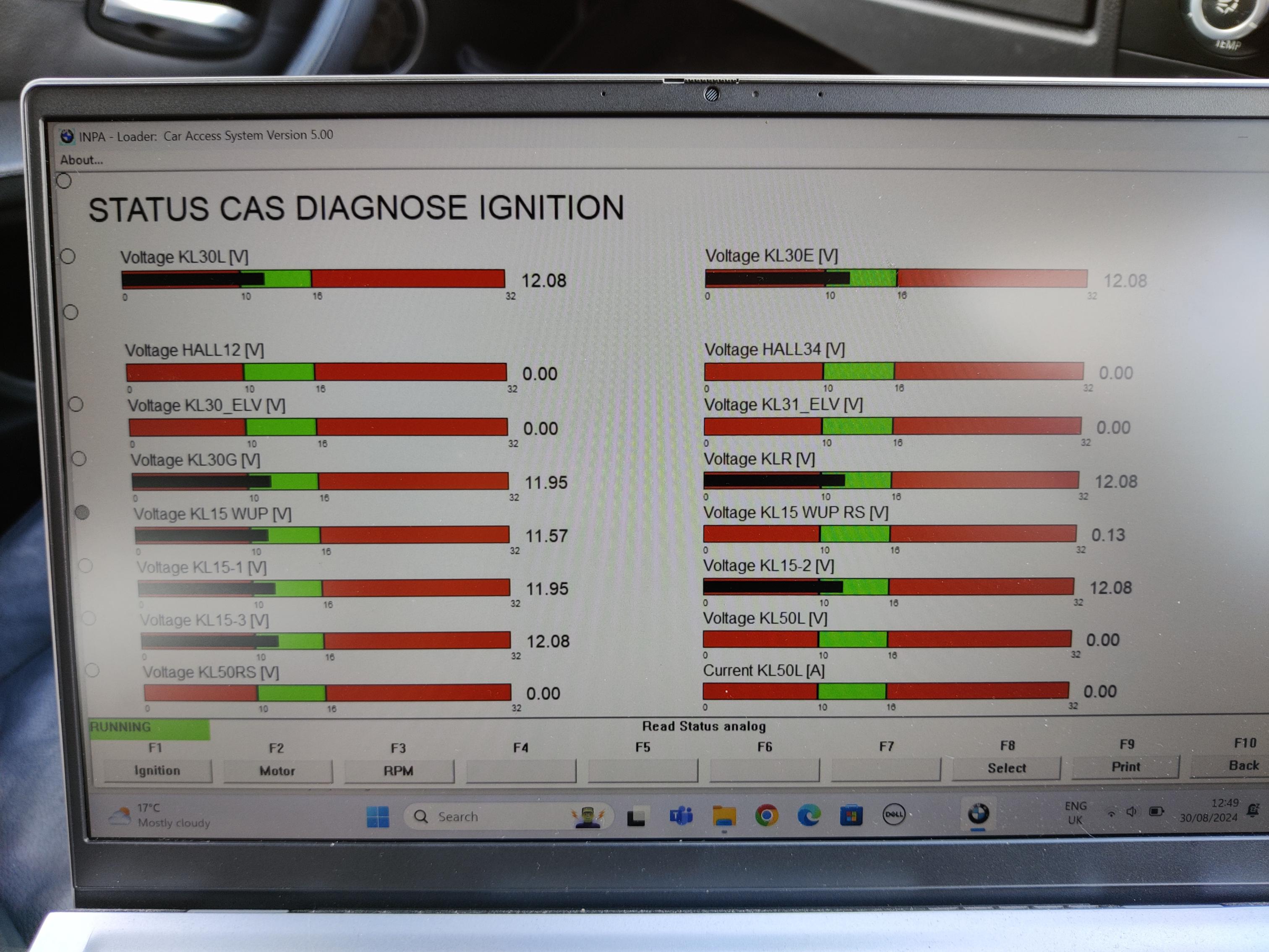

You can also see Live Data connected to CAS Module, to see CAS Terminal Status, which will show if CAS is correctly Activating Starter via KL50.
INPA > CAS > F5 > F2 Analog > F1 CAS Terminal Status
George

I have attached all the screenshots below and video of live data for cas terminal and you can see it's activating the starter when try to turn car on . I really don't know what else. I've checked all fuses they seem fine. Mechanic did come over and said the relay in glove box green one is faulty and fuse 30 for ignition but they look fine. He tested with multimeter I think and saw there was no power. So I've ordered these 2 anyway to see if it would fix but Im not sure really if it will fix . I'm thinking it's the starter. Thanks appreciate you helping me alot.
      08-30-2024, 07:00 AM   #35
moiz
21
Drives: 318 D , 330 Ci, 530i
Join Date: Dec 2023
Location: United Kingdom
The video didn't upload for some reason. But it changes voltage when I try starting the car
Took screenshot from the video to show voltage change when trying to start the car
      08-30-2024, 06:44 PM   #37
gbalthrop
3848
5,139
Drives: 2007 328xi E91
Join Date: May 2017
Location: Fairfax Co, VA
Your last ScreenPrint shows Terminal 50 (KL50L) 11.57V when START button is pressed with foot on brake, & 10.59Amp
Current. If the Starter were actually Cranking the engine, there would be ~ 2V Voltage Drop, and all your voltage readings
would be in 10V to 10.5V range. So you either have (1) a wiring fault in the KL50 voltage supply from CAS to Starter Solenoid
(there are two intermediate connectors in the E-Box) or (2) the Starter Solenoid is NOT "pulling-in" to engage Starter
Motor. While it is PROBABLY the latter, there are two things you could try to identify the cause.
1) See ISTA ScreenPrints of Wiring between CAS & Starter Solenoid, open E-box & test for voltage at connectors when START
is activated. You can also apply 12V+ to the line running to Starter Solenoid, ENSURING in PARK/ NEUTRAL, as you are
defeating the Safety Switches. Set HANDBRAKE.
2) Use a Wooden dowel or wooden/plastic broom handle to tap on Starter Solenoid (small cylinder) to see if engagement.
Please let us know what you find.
George
George
George
Hi George, ive tapped on starter with someone cranking car and still nothing, i did this test :
and i get the same results also so i think its possibly starter. Just not sure again which cables to test like you said above, im confused on which to test exactly and can i use a light probe which shows volts instead of multimeter? thanks.
