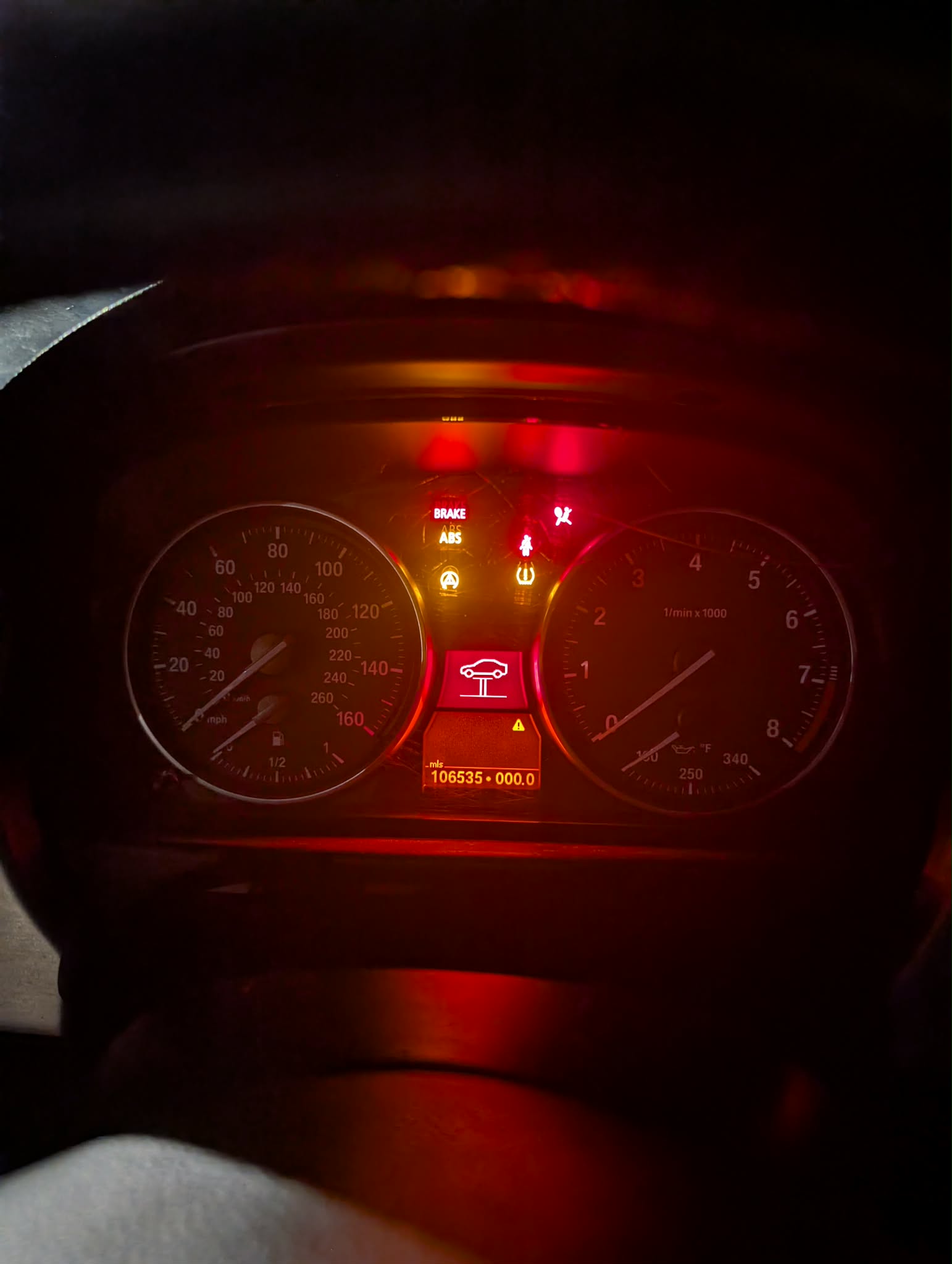

6) What Warning Lights are present on the Instrument Cluster with ignition on & engine running? A photo would be helpful.

Warning lights - attaching photo

Those are a lot of lights!
