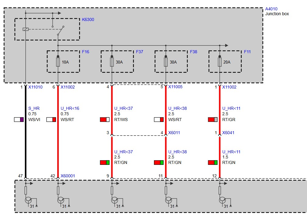

xrviz from bimmerfest has provides this information:
"Your code is indicating no voltage at the DME despite the DME main relay being switched on.
The junction box is behind the glovebox. The module at the bottom of the image is the DME.
Not sure which of the two will be easier to test at.
With ignition on (not cranking) you should get 0 volts on the white/violet wire and 12V on the other 4 wires."
see attached image.
I've replied with:
Alright so as per your diagram (which i'm still trying to find where in ISTA+ that diagram exist hehe), the connection 42 at the DME (on connector X60001) does not have power with ignition on. I have connection 12 which as power but the 9 and 11 doesn't exist for some reason on the harness, there's no wires there.
Now, connection 42 at the DME is tied to the fuse F16 (10A red fuse) which has power when I turn the ignition on, on both side of the fuse. I tested with a testing light.
So the power doesn't go from the F16 fuse to the connection 42 at the DME. I've set my multimeter at ohms and tested the resistance from the connection 42 to the F16 fuse (on both sides of the fuse) and I get a 0, which indicates a good wire...
So i need help again please. Why is that I see power at the fuse with the ignition on, the fuse is good and the wire seems to be good as well.
