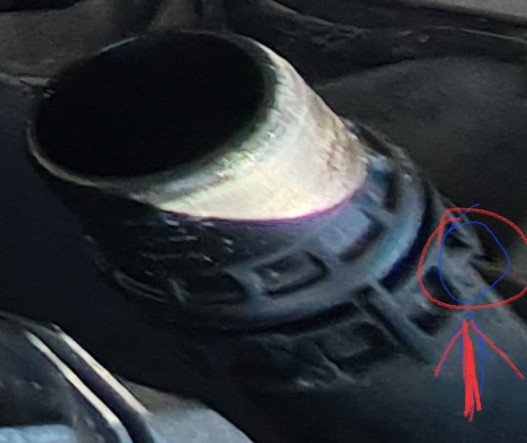

After jerking, pulling, wiggling for 15 minutes I realized the following: fitting slides easily until the back egde of the wire clip channel on the hose catches on the front edge of the groove on the radiator fitting. Since I was replacing the hose anyway, I just stuck a small screwdriver in the hose fitting and snapped the back edge off. Problem solved - the hose slid right off. If you're re-using the hose try gently prying under the back edge to lift it up over the front lip of the retaining channel.
