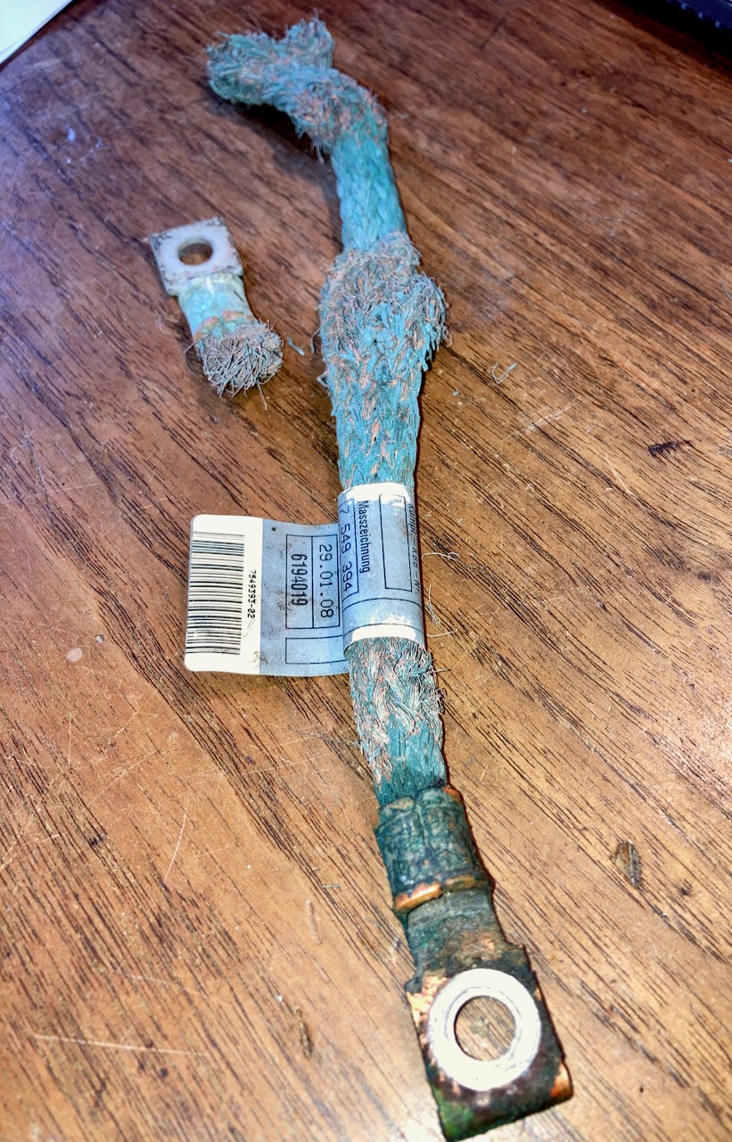

Been chasing a sporadic misfire issue for weeks. One cylinder misfiring turned into 4 cylinders when i changed sparks and coils. Thought I had damaged the new coils going in.
Leaving my air filter cowl off overnight once allowed water in to fry my (recently replaced) blower motor and resistor.
Eventually decided to check ground straps and sure enough, the small engine ground near the exhaust manifold was hanging on by a thread.
CHECK YOUR GROUND STRAPS. Especially this one that can be accessed without removing anything else.

For sure. Especially if you live or the car has lived any considerable time in rust belt areas. Worth it for other areas too, of course.

The one in the engine bay is the interference suppression band. The one underneath the chassis is the ground strap. I believe it has a much thicker gauge wire.

Exactly. The small one on the right side of the engine has nothing really to do with how the engine runs. Good to replace, but it can be removed and the car will still run.

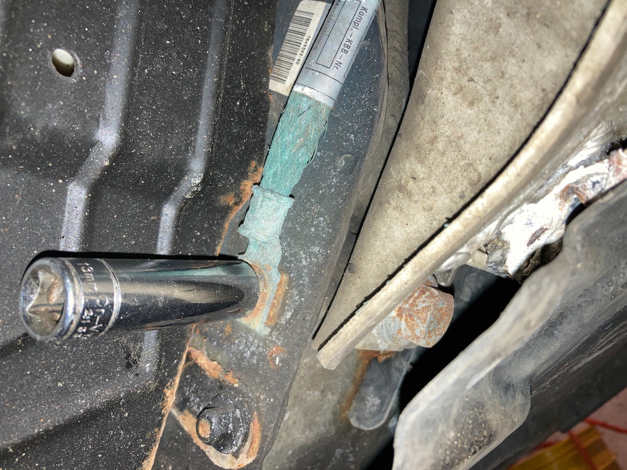

The one you need to check is the large one that is below the starter. If that is weak or broken, you will get weak starts, misfires, and eventually once it pretty much entirely breaks a no-start situation.
Here are a few photos of mine as it was being replaced.
F806speed149.00
Mike K688.00

Thanks for the information guys, I’ll check that one too. I guess it was a coincidence that the interference band fixed my misfire because I have experienced some on subsequent starts.
