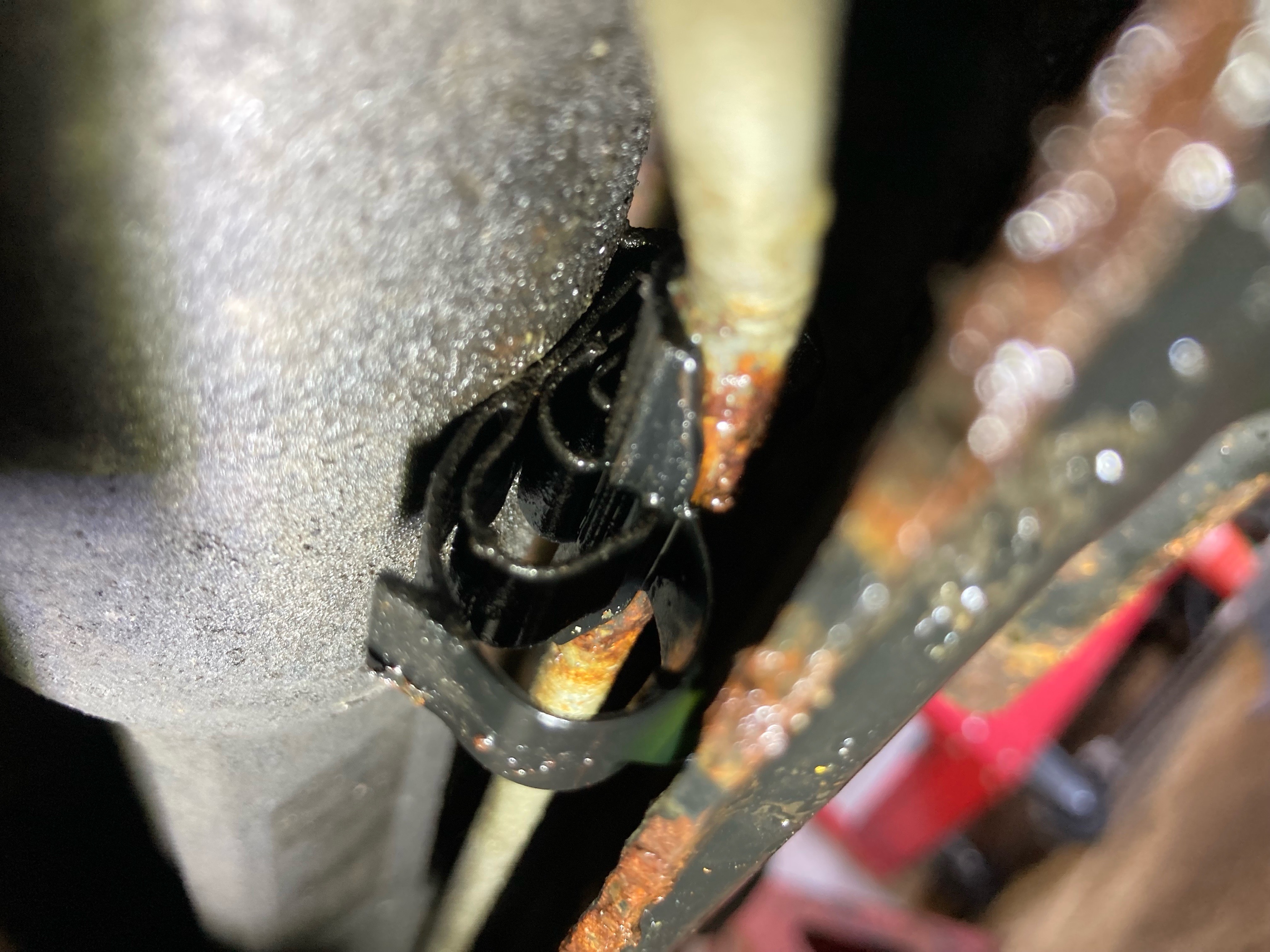

      03-10-2026, 05:11 PM   #6
JWT4700
37
116
Drives: 09 328i Xdrive sedan
Join Date: Dec 2016
Location: Meadville, PA
Junk yard rack line don’t look like they are leaking, but it was damp in the clip area. You can see the rust on the line still on the car.

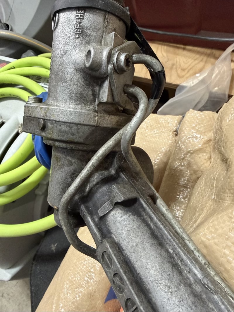

      03-11-2026, 10:39 PM   #8
e90yyc
Art Collector
e90yyc's Avatar
2875
3,774
Join Date: Feb 2018
Location: Canada
Pics attached
      03-12-2026, 08:56 PM   #9
e90yyc
Art Collector
e90yyc's Avatar
2875
3,774
Join Date: Feb 2018
Location: Canada
JWT4700 Shoot me a PM if you’d like. I couldn’t see any rust on the lines.
