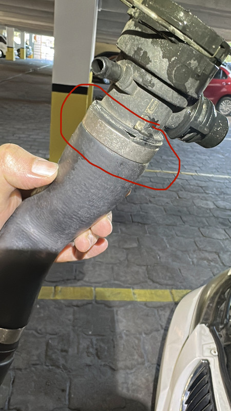

Back in November, my 330i's upper radiator hose left me stranded and I had to call a tow truck - the coolant was leaking from the coupling. I've since replaced it, but I got to wondering: what emergency options are out there to buy some extra time on the road?
I asked Claude and it recommended self-fusing silicone tape (like Rescue Tape), but I'd like to hear what you guys actually carry or have used in the field. Since I ended up waiting nearly an hour for the tow that day, I'd like to be better prepared next time.
This is the hose that failed:

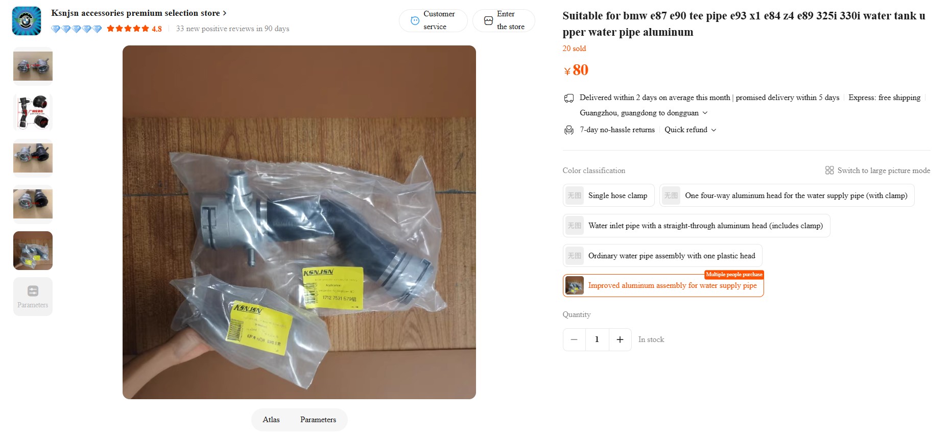

Besides carrying an extra hose and a jug of coolant, other members found aluminum connectors such as:
https://www.e90post.com/forums/showthread.php?t=2227295

This is gold!
I'm about to replace all coolant hoses following Efthreon DIY + water pump and thermostat, all preventively, but didn't know about those aluminium connectors. Seems the way to go. Thank you!

I'm assuming the o-ring in the connector failed? Not much you can do about that in the field.
As already mentioned, the best thing you can do is replace known weak points, such as the plastic vent return line above the radiator fan.
Do coolant hoses even fail anymore since manufacturers started using EPDM?

The coupling (circled in red) is the part that failed, the photo was taken the day I replaced it. I thought there might be something available that could have bought me a little extra time. Distances are short in my country, and I only needed about 20 minutes to get home, which is why I asked.
I understand that in large cities it’s different and waiting an hour or more for a tow truck is normal.
