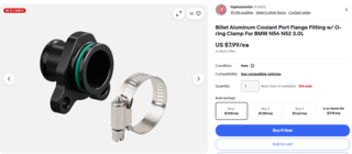

I used the Rein aluminum flange, but the o-ring material is substandard. It hardened and leaked. You might want to replace it at the beginning with a BMW o-ring.
A quick search on eBay shows $7.99 USD flange. But those are no brand ones. Rein does come with a spring clamp, which is better than the worm gear clamp in the picture below.
https://www.ebay.com/itm/195821005718
