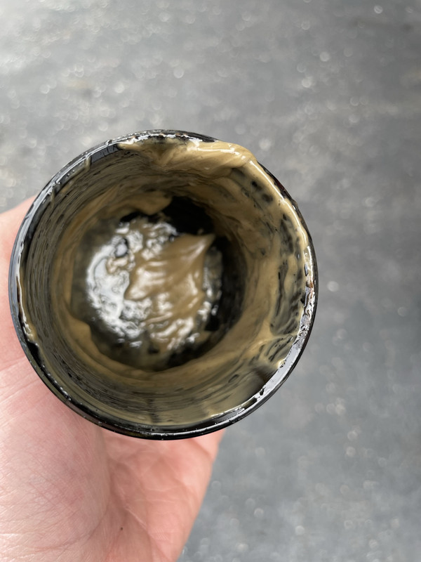

Is this normal for the oil to looks like this on the vacuum side of the BMS OCC? Oil inside of the engine is fine, I just changed the oil

From what I know, ( not a lot ). You either have a blown head gasket, your oil filter housing gasket is bad, or you don't let your car get up to full driving temperature when driving and you shut it off early, ( like if you work 5 minutes from home ).

Yes, it's normal, just a mixture of water, oil and cold temperature.

+1. Drive the car longer, and as it gets warmer out it will be less like this. Completely normal. In colder months I keep a glove on my can, may do nothing but I don't care.

Thanks all, makes sense

This is exactly what it looks like in both of my catch cans. Good to know they're doing their job!

I have a Vtt breather cap, no engine covers or cowls, cold weather (canada) and my oil never looked like that in my catch can! Wtf!

You probably don't take trips less than 20 minutes often, do you?

I don't either really though, cold weather half the year.. I can't figure it out yet. Seeping through valve cover building up condensation
